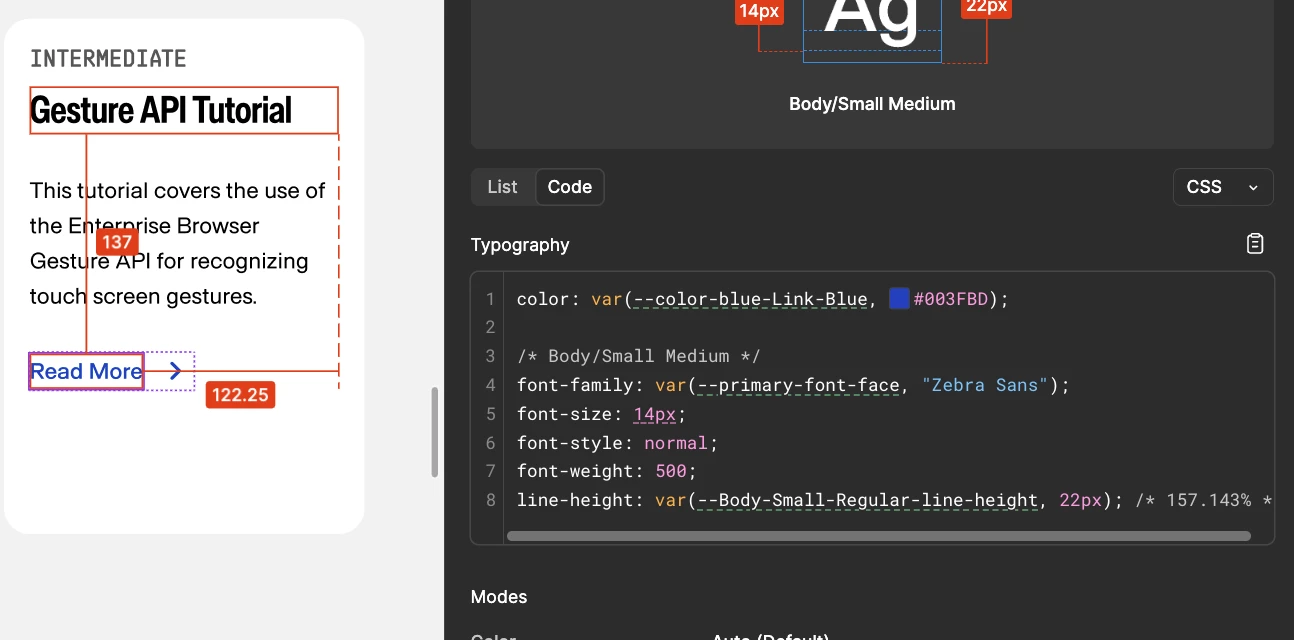

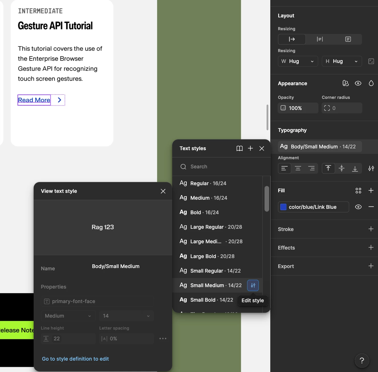

Attached are what I see in design/dev mode on my machine (dark mode screens) and also what the developer sees on his machine (light mode screenshot in dev mode)
    Weier_Matt
    Mar 18, 2026 7:25 PM UTC
    one more screenshot from my end (the designer) showing what I see in Dev Mode for the font-weight.  As you can see I see font-weight 500 but the developer saw font-weight 400 as shown above.  This was even after trying my “switch the definition and switch it back” hack which sometimes works.
