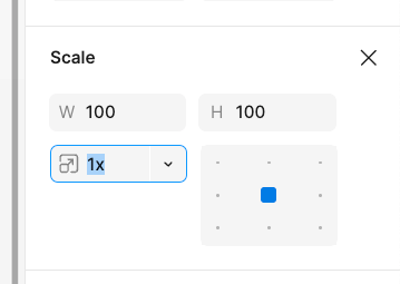

In design mode, when I select an object with a Move tool (V) and then click K to select a scale tool, scale factor input field is already in focus and I can quickly scale whatever, for example, by pressing K + ½ + Enter.
How it works in Design mode after I selected with Move tool and clicked K once

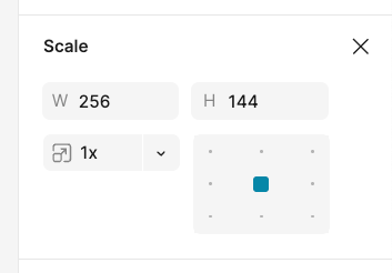

However, when I tried the same in Draw mode, it didn’t work as a scale factor input field is not put in focus right after I click K button and thus I need to click K again to get this field focused.
How it looks in Draw mode after I selected with Move tool and clicked K once
