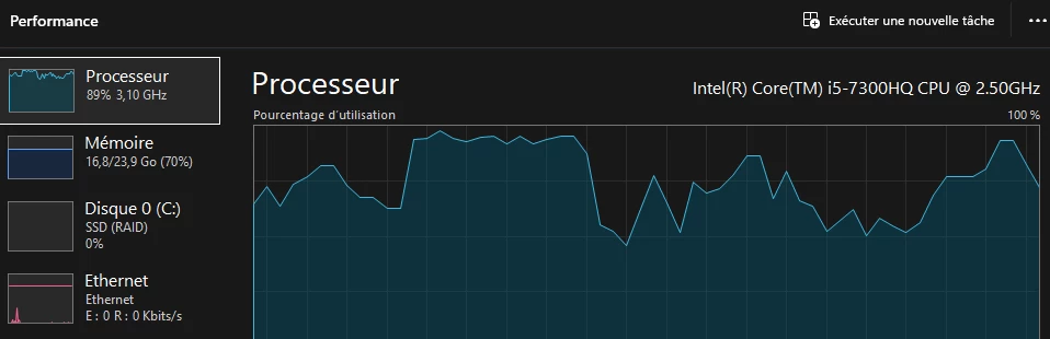

Greg97
Sep 18, 2026 8:35 PM UTC
Hi ksn, thanks for getting back to me.
This happens across every file I try to preview.
I first noticed the issue on September 18 at around 10:00 AM CEST. I had not experienced this behavior before that date.
I also tested this with a completely new and very simple file containing only one frame, two rectangles and one text layer.
After completely closing and reopening Figma Desktop, the first Preview of this file takes around 2 minutes 40 seconds to load. During that time, Figma uses around 70–80% CPU and freezes for the entire duration, making the PC almost unusable.
If I close the Preview and open it again without closing Figma, it takes around 25 seconds.
I can also reproduce the same behavior on Figma Web. The first preview takes around 1 minute to load and if I close the preview and open it again, it takes less than 10 seconds.
Duplicating the file does not change the behavior either.
OS infos: Windows 11 26H2 - 26300.9539
CPU: Intel(R) Core(TM) i5-7300HQ CPU @ 2.50GHz (2.50 GHz)
RAM: 24,0 Go
Figma Desktop & Chrome: Latest version
