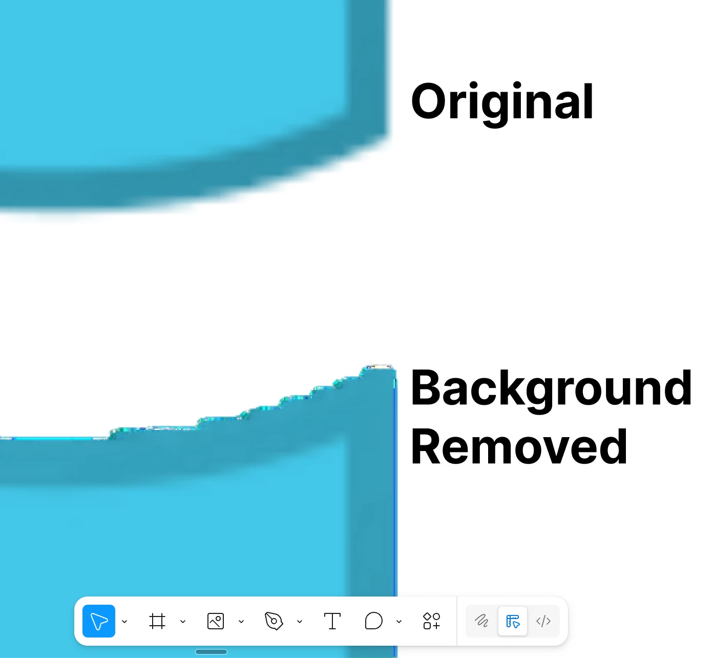

I did some more testing with a PNG file and was able to reproduce some color shifting around the edges, especially at smaller sizes. Here's an example from my test:
Original vs. Background Removed
The top image is the original, and the bottom has the background removed — you can see the saturated colors along the edge. Does that match what you're seeing, or is the color shift indeed spreading across the entire image? And how noticeable is the saturation change in your case?
One solution I've found: You can clean up the edges using the Pen tool with a Subtract boolean operation. It works well for simpler shapes, though I realize it may hit a limit with more intricate images. Would that be a viable option for your workflow?
