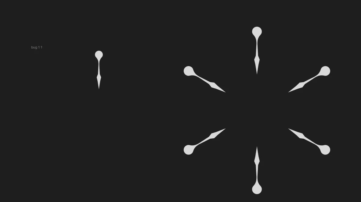

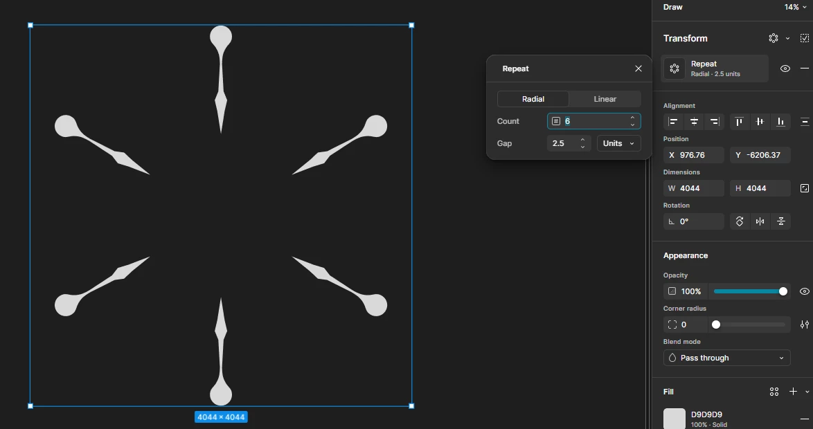

But there’s an issue with it. As you can see here, I tried to use the radial repeat for the shape.
Next I’ll save the radial repeat group to SVG and use it in Figma.
As you can see, the result only saved the main shape, not all the radial repeat group. Well I can just save it as a PNG, but when it comes to detail, SVG is unmatched.

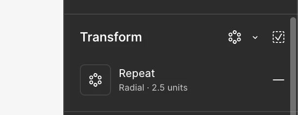

After adding the radial repeat to the object, did you click the checkbox icon to apply the transform? I’m wondering if you haven’t done that, because it doesn’t actually create individual layers of each repeated object until you apply the transformation.
You can see the checkbox to the top right.

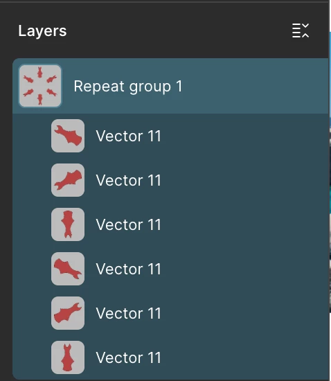

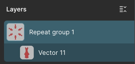

Layers before applying.
Layers after applying.
