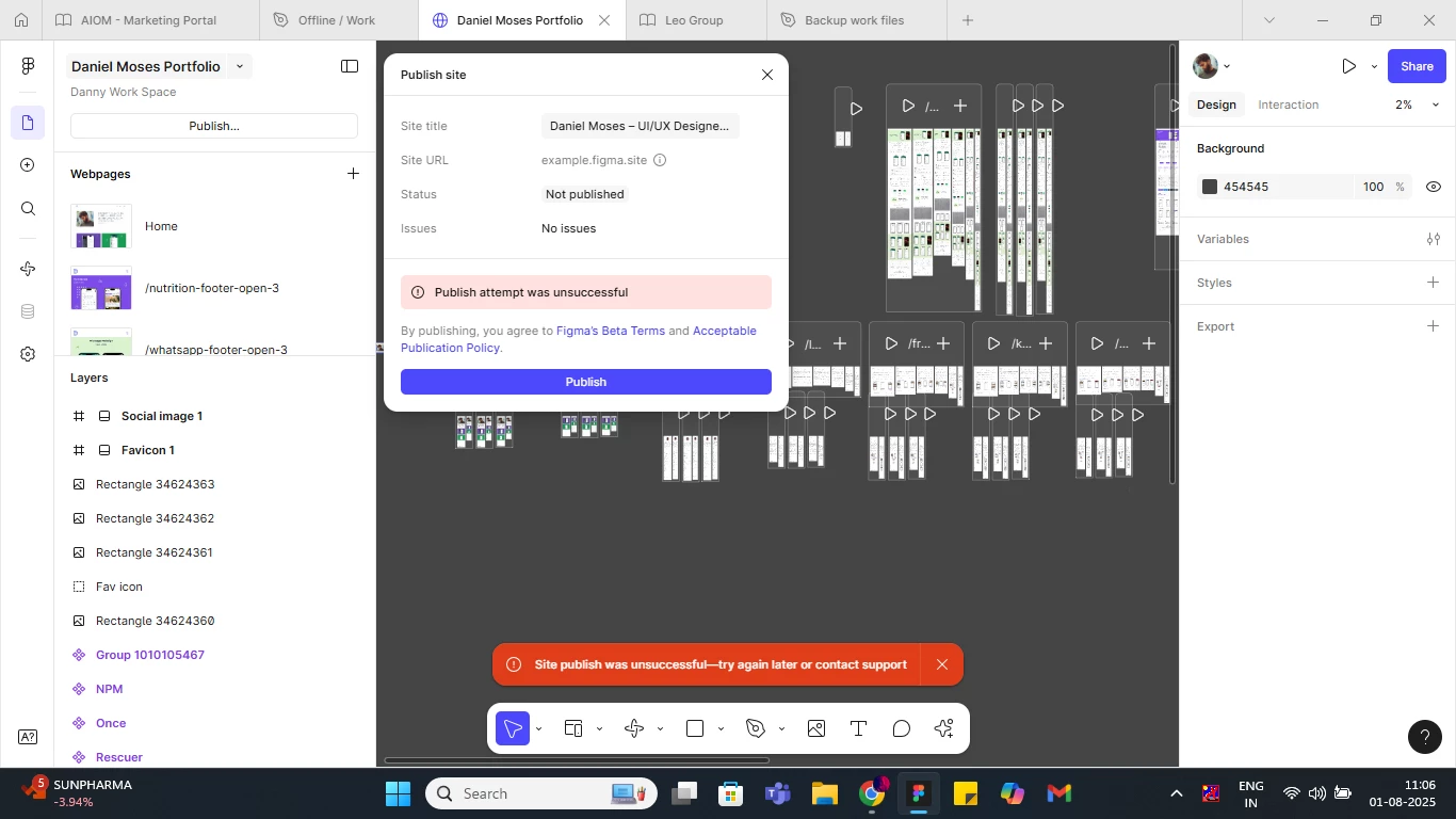

​@Tom Reem. Thank you for pitching in. This issue is been solved by Ryan. Will let you know if I face it again.
​@Daniel Moses we tried 2 things in this case :-
1. At the extreme left bottom if there is an icon button with (A?). That means you are using a font that is not a Google font and figma only supports Google font and not machine fonts.
2. If you are using any Video in the file make sure it is not more than 10,485,760 bytes.
In my case it was both custom font as well as had a video with more bytes.
I hope this helps you.

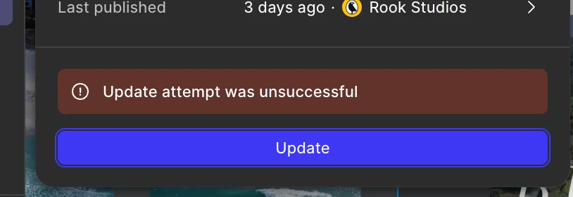

Helen Shek
May 15, 2025 11:06 PM UTC
Hi ​@dvaliao I am having a similar issue where it was working fine but now I am getting “Update attempt was unsuccessful”. There are no issues to review and I have a full seat as an individual user.
I tried to restore but it still didn’t work. Can you please help? I have a portfolio presentation tomorrow!
djv
May 16, 2025 3:16 AM UTC
Hi ​@Helen Shek, thanks for reaching out!
Can you please send your file link to our support team here? https://help.figma.com/hc/en-us/requests/new
Our team can take a look at the backend of Sites to find what’s causing this for you.

Daniel Moses
Aug 1, 2025 5:41 AM UTC
I have tried publishing it for the fourth time, every time I’m getting the same error message. Please help me to get this issue fixed
