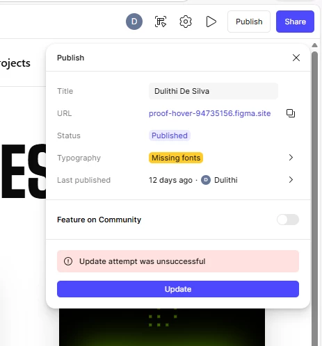

Publishing the updated version on website in Figmake is unsuccessful
Publishing the updated version on website in Figmake AI is unsuccessful. Tried to fix it in several times, but same error message will come

Hey ​@Dulithi , Celine from Figma here. Thank you for flagging this and sharing your screenshot.
I see that you have ‘Missing fonts’ error message, which is a warning that you need to Manage Missing Fonts.
To check for missing fonts in your Figma Make file, click Publish at the top of the screen. If any fonts require web font files, you'll see a warning under Typography in the Publish modal.
You can publish without resolving this warning, but any missing fonts will fall back to the browser's default font on the live site.
To upload a missing web font:
  1. In your Figma Make file, click Settings at the top of the screen.
  2. Click Fonts.
  3. Click Upload to add the .woff or .woff2 file for each font listed.
After uploading, click Publish to publish or republish your app with the new fonts included.
For more context, you can also check our Help Center article: Upload a web font to Figma Make.
