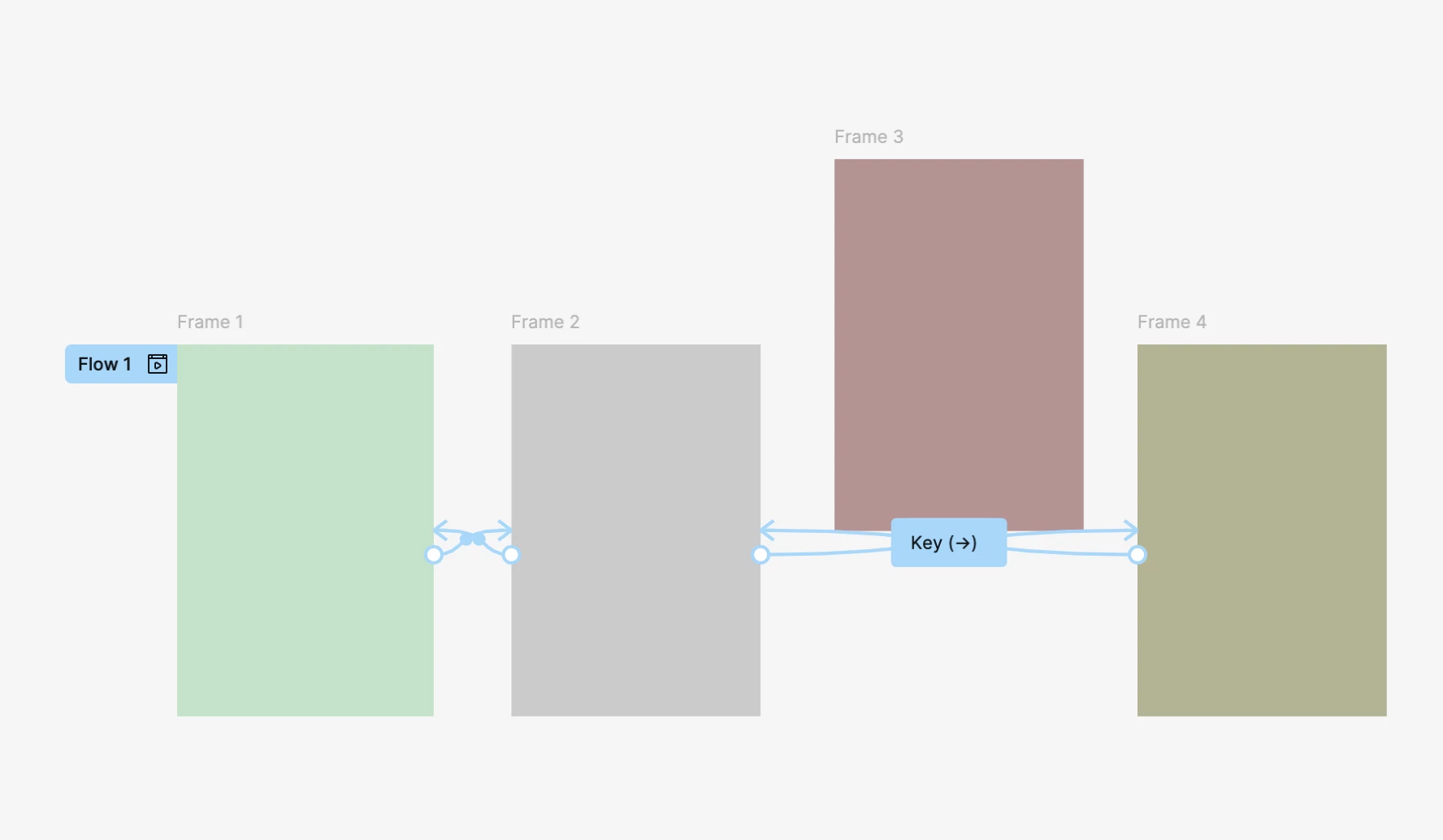

Is frame 1 your starting point, ​@Lenin? I set up a simple page with four frames and interactions (leaving out one from just so I knew for sure it wasn’t simply going from one frame to the next). I didn’t see what you describe with frame one. However, pressing the right-arrow key on the final frame goes back to the second to last frame. I could add another interaction to go back to the beginning, though. Here’s a screenshot of what I set up to test with:
A screenshot showing the interaction flow with four frames.

Yes frame 1 is my starting point, this is the interaction that i get. Also this interaction occures when you do this from the beginning frame (frame 1) and press left, you will get stuck between frame 1 and frame 2. I’ve added a screen capture.
Adding a interaction to proceed to the beginning isn’t viable for every use case when making a prototype that contains a specific flow with a start and an ending.
While presenting you do not want to reset your prototype and walk through the whole flow again. You want to be able to simple press your arrow keys for the previous path the frames where walked through.

I can’t tell what keys you are pressing from your video, though that is unusual that it goes back to Frame 2 from Frame 4, and then after that I see it just going back and forth between the first two frames - not what I saw with my own test file. Could you share your file with support-share@figma.com with edit access (this won’t affect your billing)? I’m going to create a ticket for you with our Technical Quality team so they can investigate. Thanks!
