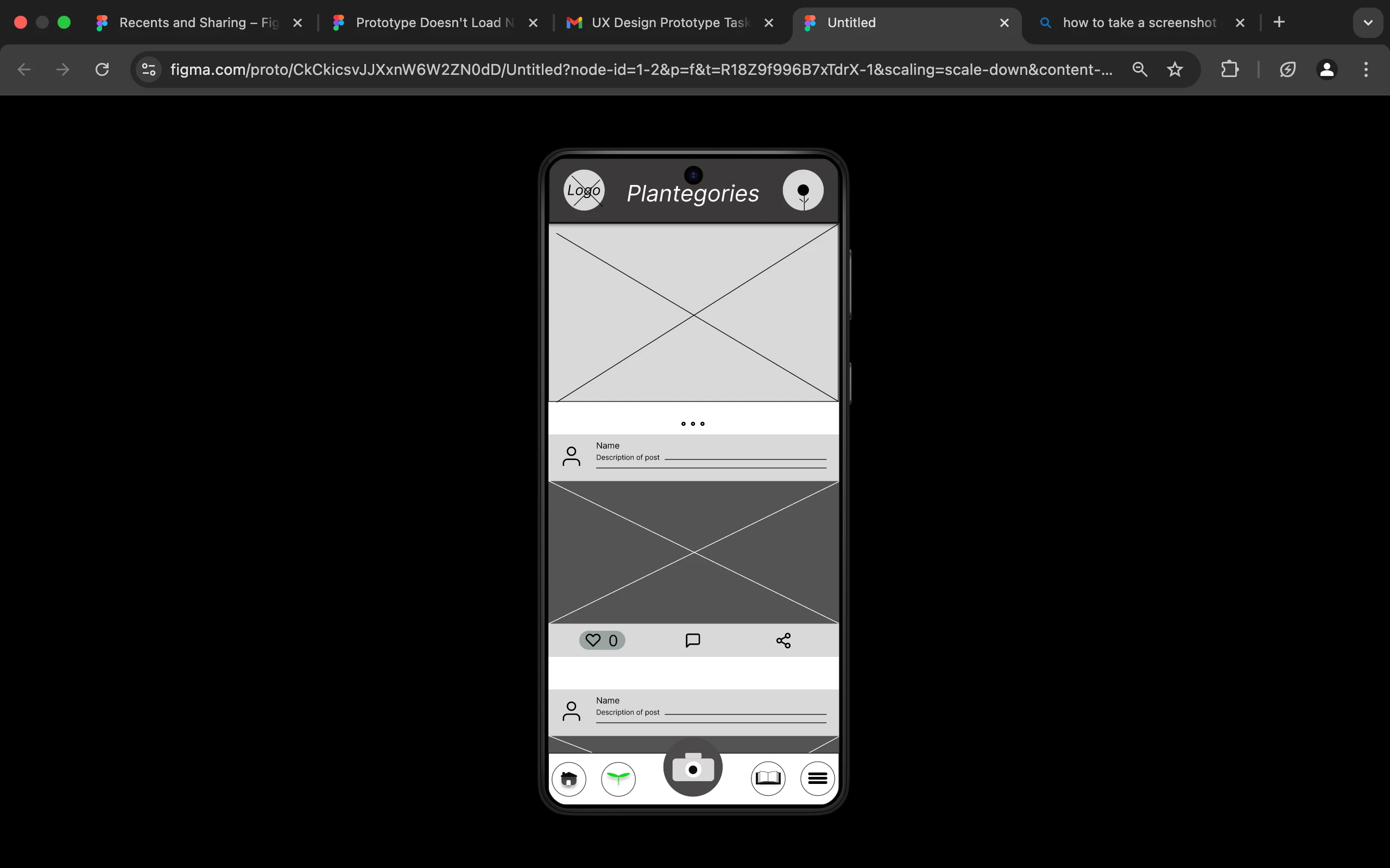

Yes, I’ll attach screenshots of different examples. I tried accessing the link from my phone as well as my laptop and even opened all the links I had sent out, they were all the same link, and every one populated the navigation bar for me. The couple of people that have gotten back to me don’t see the navigation pull up on their end. I thought maybe it was the browser they were using so had them try a different one and had them try using a computer/tablet if they were using their mobile phone and vice versa, but the issue persists.
This image is a screenshot of my laptop when I open my prototype link that had sent out to my testers.
This is a screenshot from my phone opening the same link I sent out to my testers.
This is a screenshot I grabbed from the video one of my testers sent back. The navigation bar is non-existent for them and there even appears to be just a blank white space toward the bottom where the nav bar should be.
This is another screenshot from a different tester, nav bar is also missing for them.

Thanks for sharing the details! Do you happen to know if the navigation frame is set to "Fixed" when scrolling? You can check out this guide for more info: https://help.figma.com/hc/en-us/articles/360039818734-Prototype-scroll-and-overflow-behavior#h_01HHN69W8T17A4A5T2EV7BGKEK.
If it’s set to "Fixed," you should be able to see it at the fixed position even if the screen size is different. Could you double-check that setting?

Yes, I’ve double checked every frame that has the navigation bar and they’re all set to a fixed position. I have submitted a bug report on this and am trying to get some further insight into this issue.

I might know what the problem is: it won’t show on the mobile web, but you can see it in the preview. If that’s the case, here’s a solution:
  • Extend the frame height to fit the entire prototype vertically.
  • Place your Nav Bar at the very bottom of the frame and set its Scroll Behavior to Fixed.
  • Set the Nav Bar’s Vertical Constraints to Bottom—this will keep it sticky at any viewport height.
  • In Prototype settings, select a device that matches your original frame size—this ensures proper preview display.
