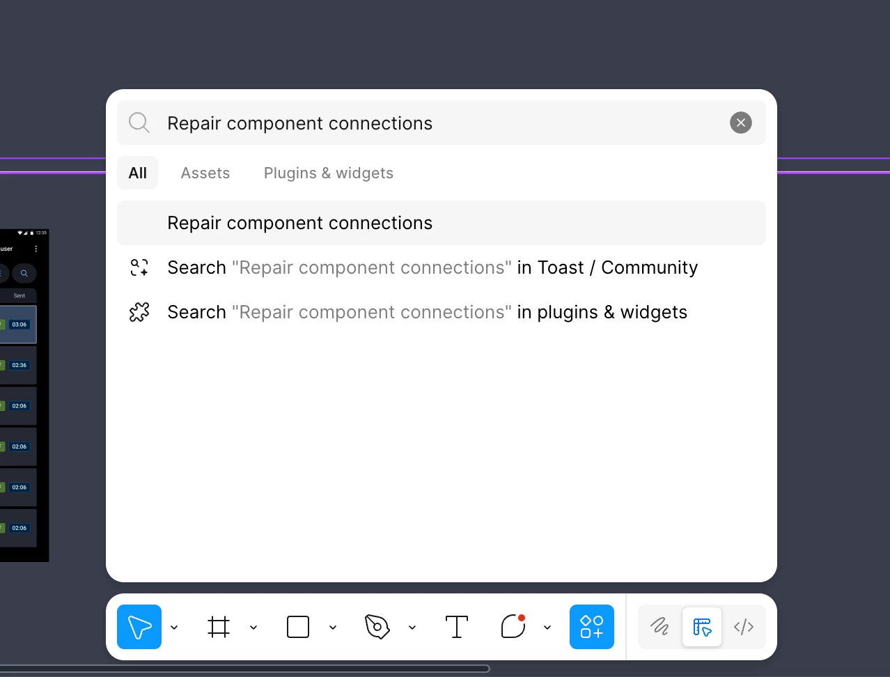

Updated guidance for those following this thread:
  • If your file is not on a branch and does not contain branches:
    • Reload the file.
    • Select the instance showing the error (or select multiple instances or the entire page if there are many different instances showing the error).
    • Run the “Repair backing component set” quick action (Command K on MacOS or Control K on Windows, then type in “Repair backing component set”, then select and press enter).
    • This should clear the error. If you notice that the ordering of values in the dropdown menu for each property are different than the source, you can further run “Repair component connections” to resync with the backing component set.
  • Otherwise:
    • Make a small change to the backing component set of the instance that has the error. Re-publish the component set and accept updates in the consuming file(s) that have the error.
