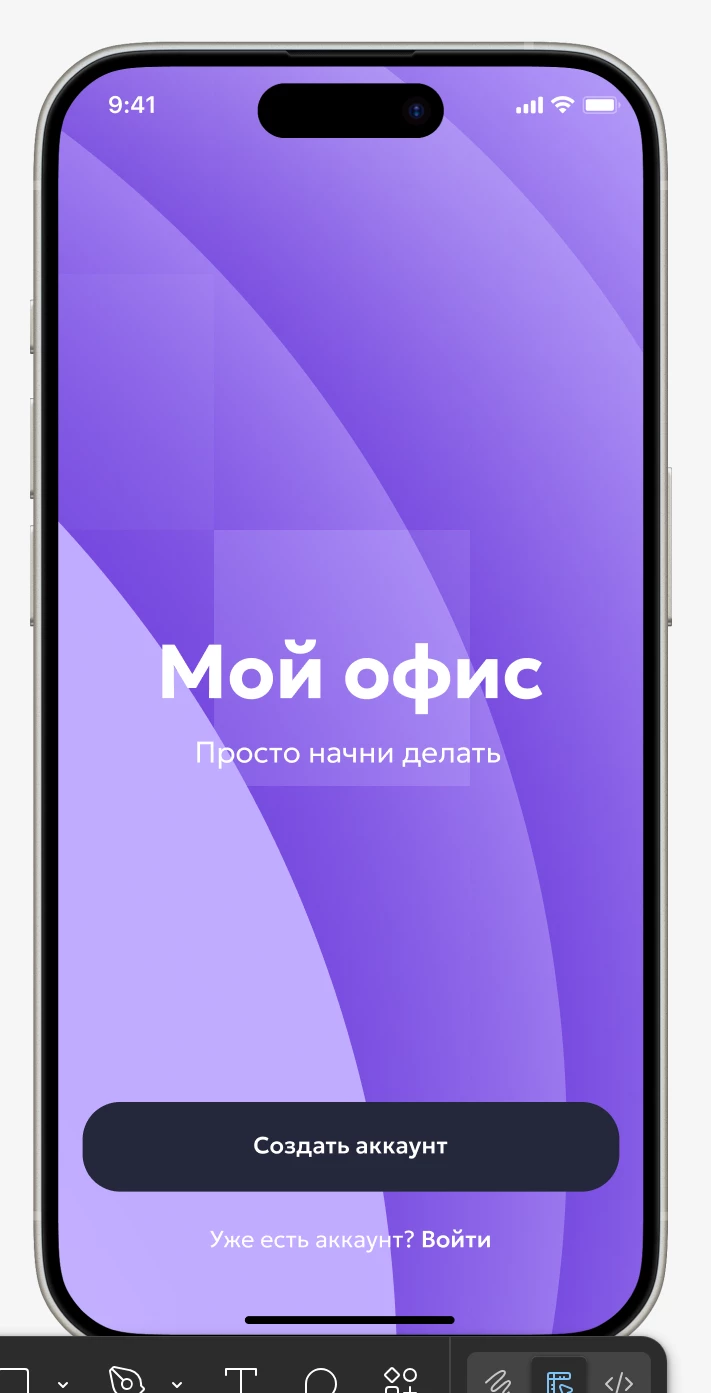

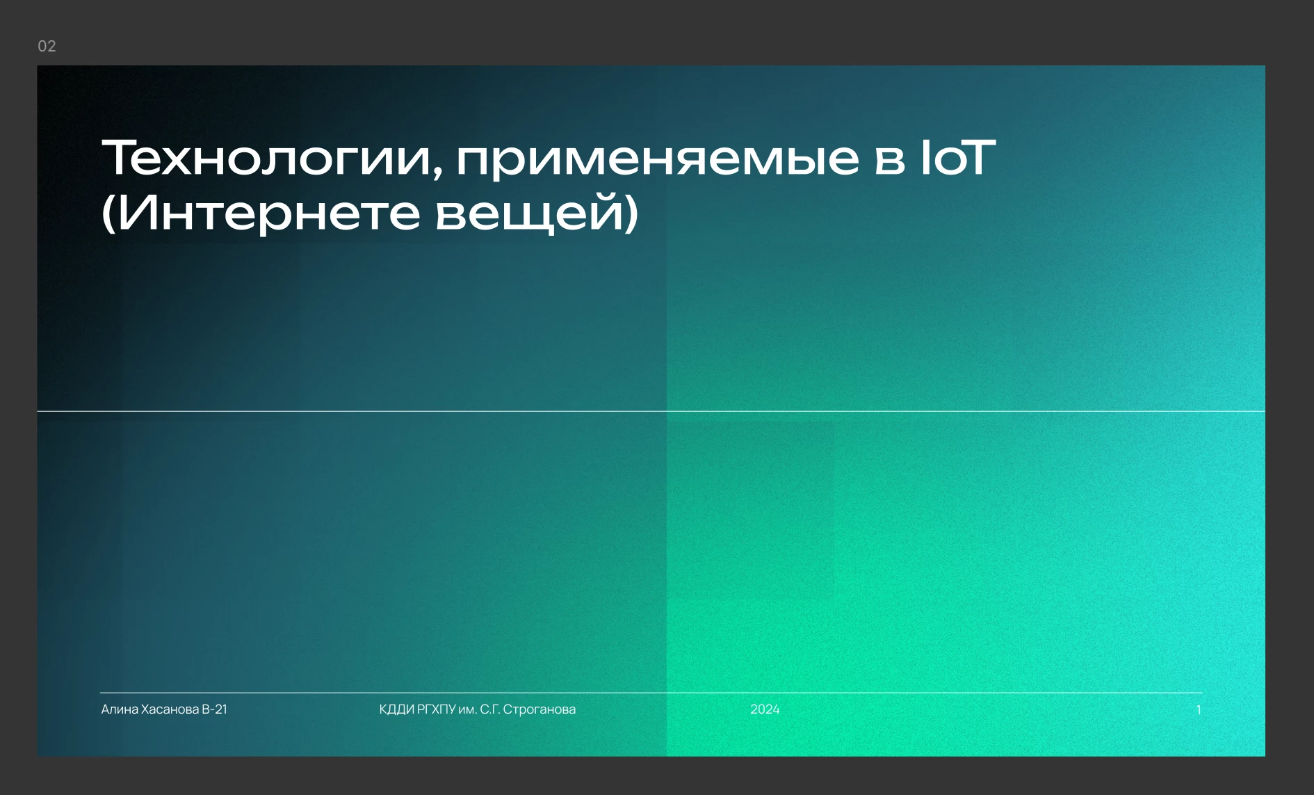

problem with rendering gradients
There is a problem with rendering gradients. Everything looks great in the preview, but in the workspace there are terrible artifacts. the problem also concerns effects and blend mode. redmibook pro 15
Есть проблема с рендерингом градиентов. В превью все выглядит великолепно, но в рабочем пространстве - ужасные артефакты. проблема также касается эффектов и режима наложения. redmibook pro 15

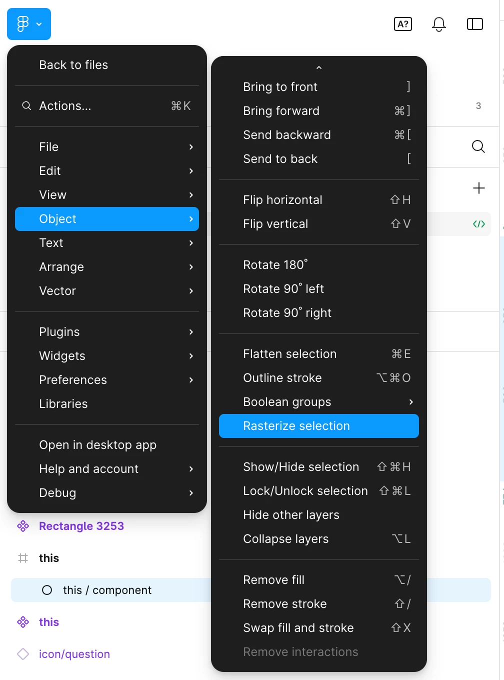

    Are you by any chance exporting to SVG?
    If so, please note that SVG does not support angular gradients, only linear and radial. If this is the case for you, the best temporary solution would be to rasterize the object in Figma, which you can do by first selecting your object then navigating to the main Figma menu in the upper left, then go to Object > Rasterize selection.
    Hope this helps explain, but please let me know if you have any further questions!
