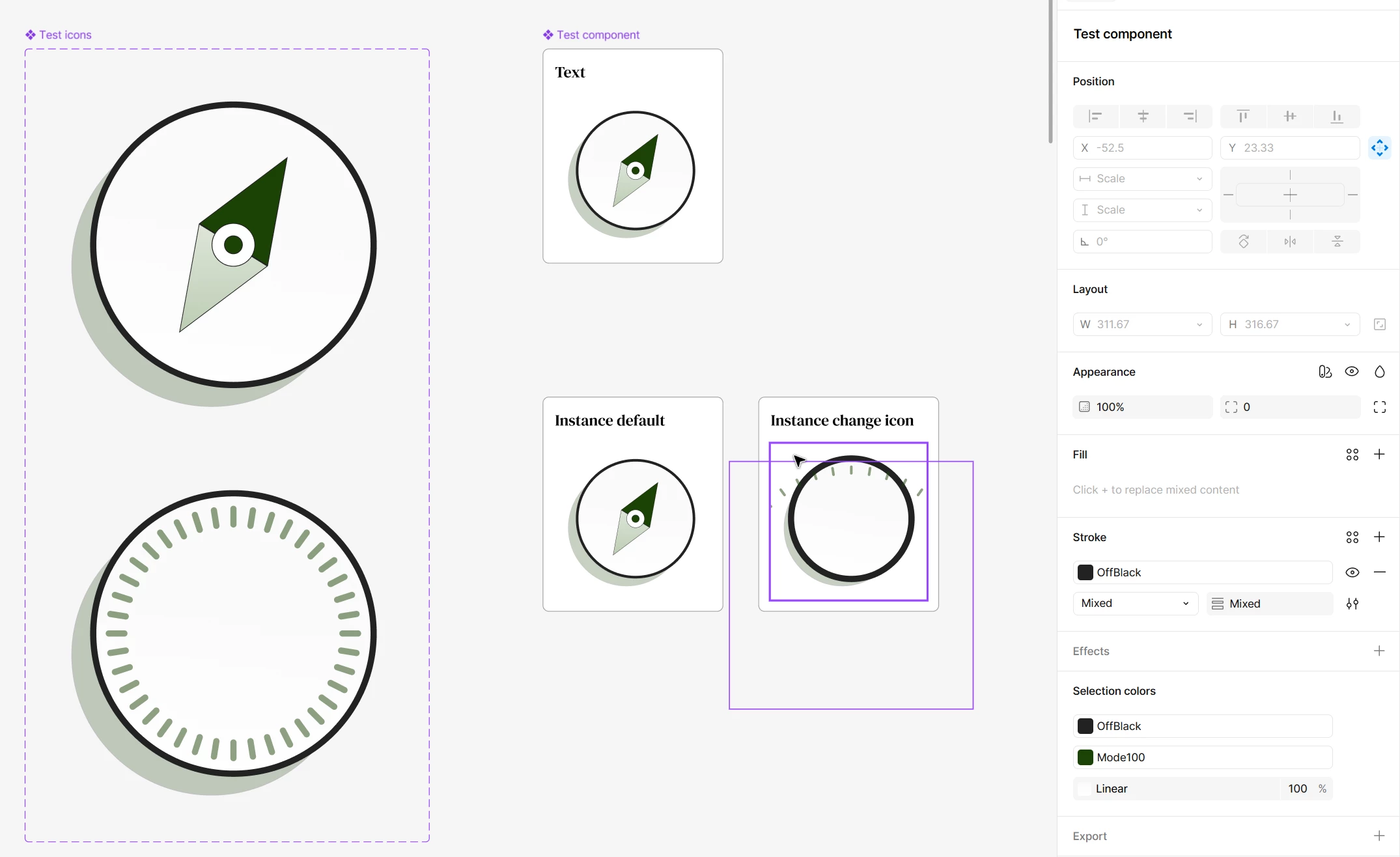

Hi,
We have made several icons, some of them using repeat groups.
The icons are grouped in a component as variant.
These icons are used in different sizes over different pages in different components, for example a card. Since you can’t resize a repeat group with the drag-tool we used scale (K) to resize the icons to appropriate size.
But when using the new component/card and changing the icon, it falls back to resizing the image inside the image component and not keeping the scaling.
I have tried different solutions inkluding “Regenerate all instances” and rebuilding the entire component but the problem remains.
Have attached an image of a test components.
