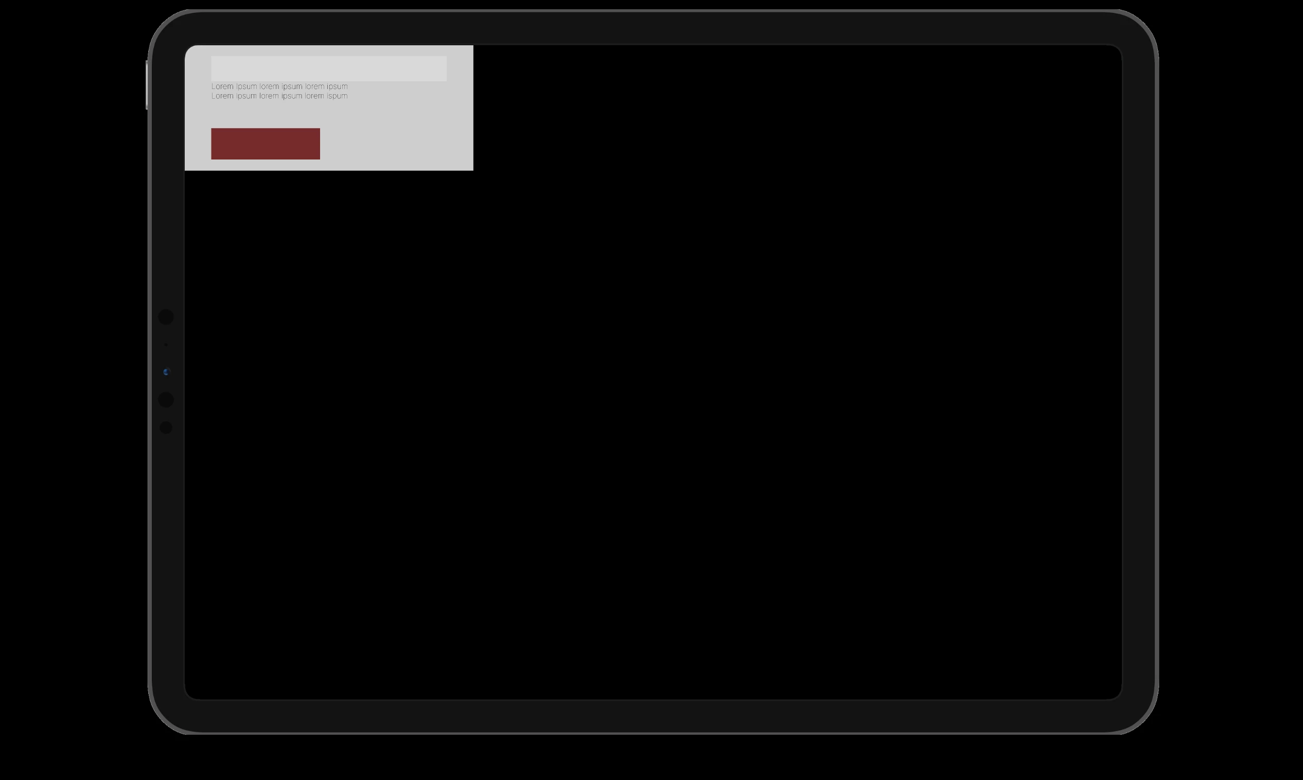

    Does this happen in all files, or just the designs in one particular file? If it is a single file, if you create a very simple frame with a few layers in it within it, does that work correctly in presentation view? I tested this with my prototype settings as an iPad 11” mini in landscape and saw this:
    A screenshot of presenting a prototype.
    This was the same for me in Chrome and the newest version of the mac OS desktop app.
