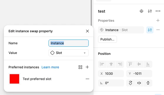

Hey! I have a small but annoying problem. I recently created a new component with Slot, Instance swap property and preferred values. When I use the component preferred values don’t appear by default for some reason. It worked correctly for components I created some time ago, but doesn’t work anymore—you always need to switch the filter.

Instance swap setup with preferred values:

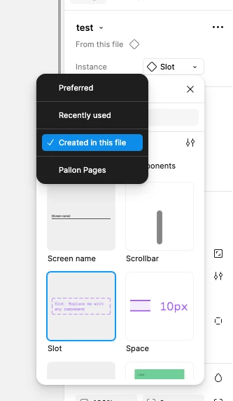

Choose instance dialog with filter Created in this file applied by default:

Make sure “Slot” is ticked within the Preferred Instances list. Having the instance in your main component isn’t enough, it has to be actively ticked in the menu. Your screenshot suggests that only “Test preferred slot” is ticked.
