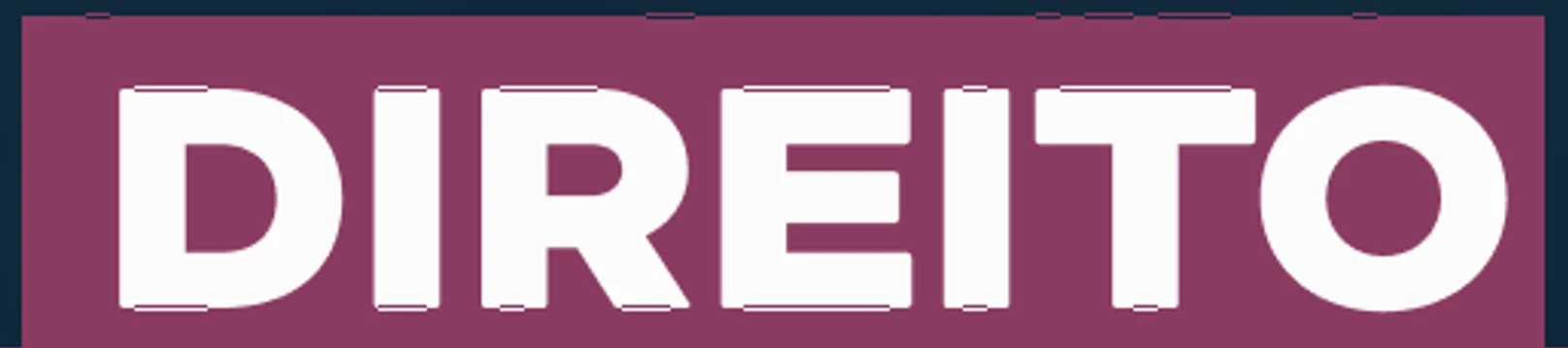

I’m experiencing a recent issue when exporting PNG files from Figma. Even with all elements aligned to the pixel grid (X, Y, width, and height are integers), “Snap to pixel grid” enabled, and no effects applied (like blur, shadow, or feather), the exported images are showing unwanted blur and visual glitches.
This did not happen before — it seems to be a new behavior. I’ve already tried exporting at 1× and 2×, using slices, double-checked parent frames, removed auto layout, and ensured everything is aligned — but the problem still occurs.
I’d like to know if this is a recent bug, a change in how Figma handles exports, or if there’s any fix I’m missing.

Thanks for the reply. I want to clarify that I've already tried everything technically possible to solve this issue on my end. Here's what I tested so far:
✅ What I've tried (none worked):
  • Aligned all elements to the pixel grid
  • Verified that all X, Y, Width, and Height values are integers
  • Activated "Snap to pixel grid"
  • Exported at 1× and 2×, with and without slices
  • Deleted all Figma cache files (AppData → Roaming → Figma)
  • Used Figma Web instead of Desktop
  • Removed all blending modes and effects (blur, shadows, etc.)
  • Outlined all text layers
  • Exported to SVG and PDF, then converted to PNG externally
  • Created a brand new file from scratch and recreated the elements manually
Despite all that, PNGs still export with blurry edges, rendering glitches, and unwanted anti-aliasing, especially on logos and sharp vector shapes.
I'm now convinced this is either:
  1. A recent bug in Figma’s rendering/export engine
  2. Or a change in how Figma handles rasterization (which didn't exist before)
Would appreciate if the team could investigate this further.
Other users are reporting the same issue too, which suggests this is not isolated.
Thanks in advance!

​@feolds Hi. Did you manage to export something clean ? We are having the same problems here (3 persons), tried all of the above and nothing works either.
Best I can do is export to PDF then rasterize through Photoshop, but even PDF export adds bugs (a phantom line, elements disappearing...)

​@feolds Updating my graphic card drivers solved this
