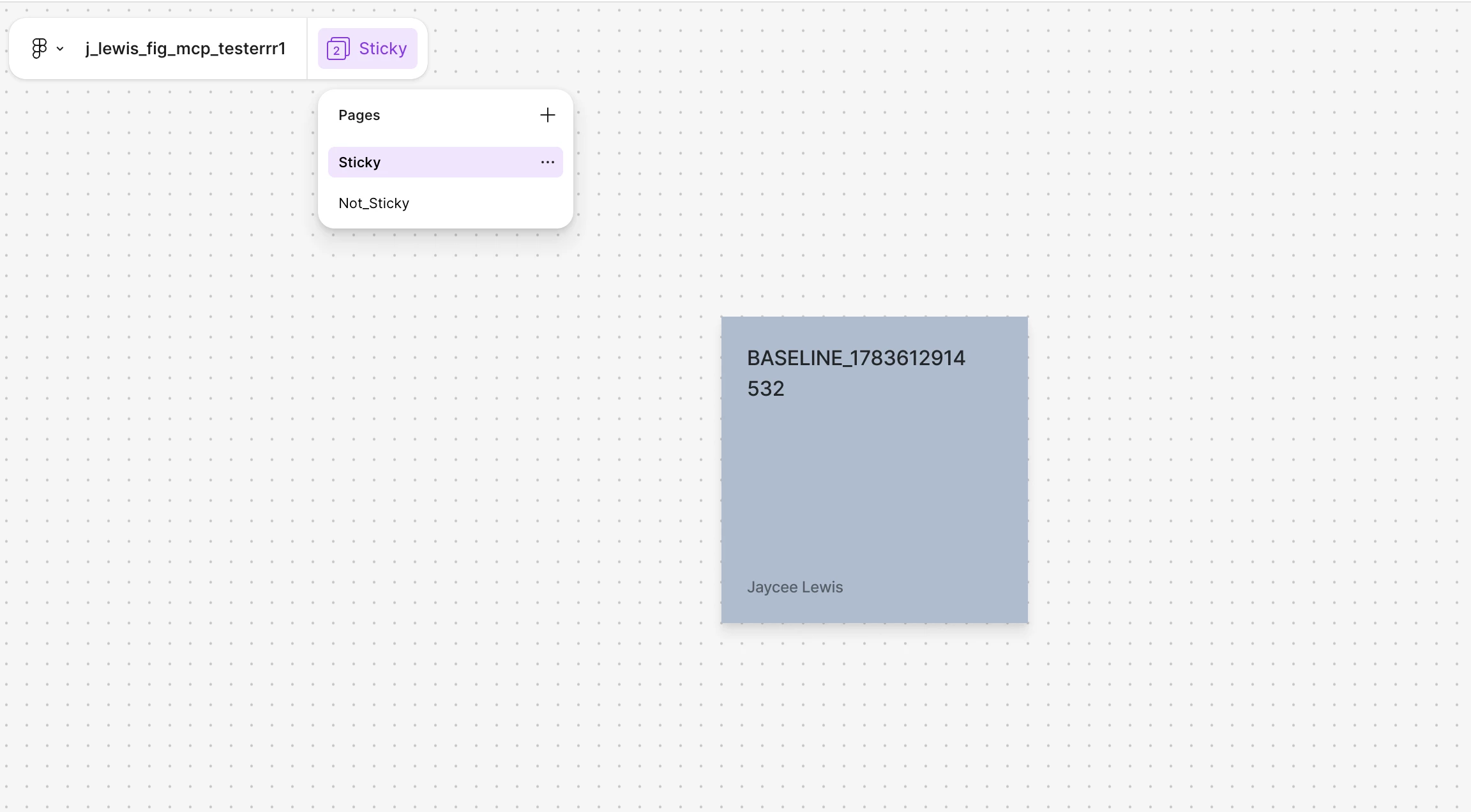

Suspect (mutate, then throw):
Error: Diagnostic: wrote "SUSPECT_1783613320601", was "BASELINE_1783612914532"
at <anonymous> (PLUGIN_1_SOURCE:8:16)
Fresh follow-up read:
"currentValue": "BASELINE_1783612914532"
→ still shows the baseline value — the SUSPECT_... write was discarded.
Screenshot after both tests for issue #3
I took all 3 issues to the MCP team for guidance. I’ll post back here with any updates or next steps for us. Thanks again! — Jaycee
