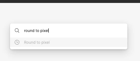

To resolve this you can either manually change its coordinates from the Properties Panel, or by using the Round-to Pixel function from the menu:
  1. Select that object and go to main menu - from there choose quick actions
  2. Search for Round to pixel

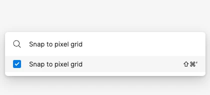

I'd also suggest also activating Snap to Pixel Grid to see if that helps. You can also enable it from the main menu - Quick actions:

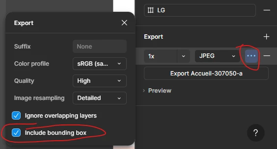

Or else you can just turn on the clip content option to the outermost frame , it will cut the minor shadows, strokes or element and you will find in the preview that there is no white border now.

Have you tried this ?
