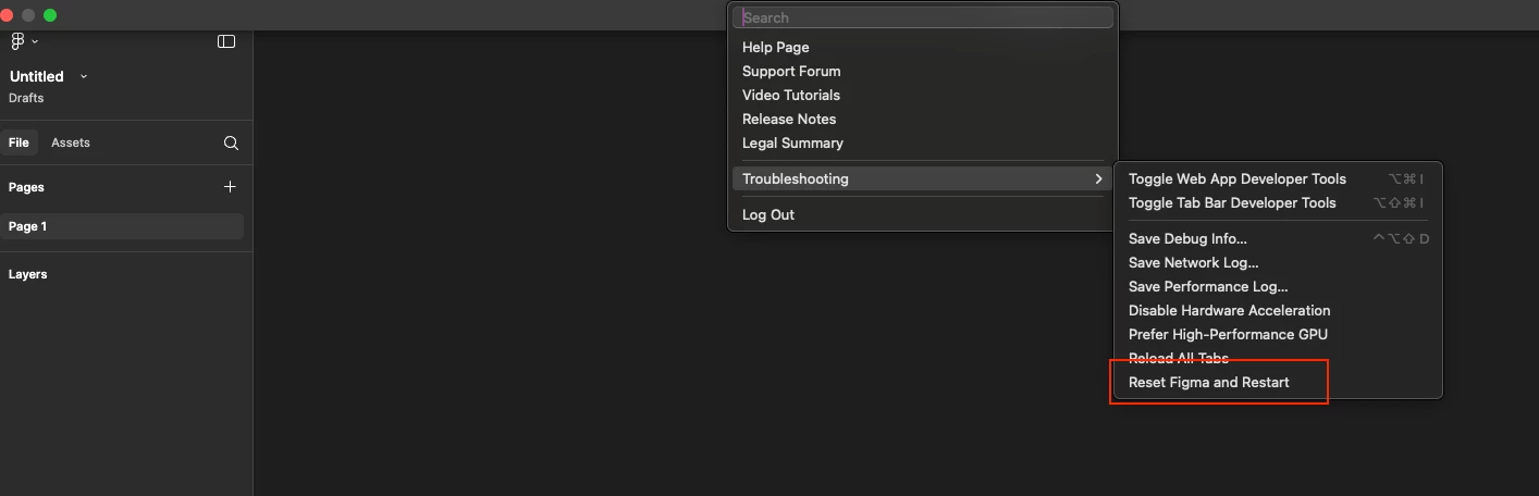

Hi ​@Yihong - this is a bit of an older thread you posted on, but I’m assuming you’re having this issue while using our desktop app. If that’s not correct, let me know.
If you are having this happen on the desktop app, can you try the following?
Go through this process in the menu Help > Troubleshooting > Reset Figma and Restart
Can you see if that fixes your annotation visibility?
Yihong
Oct 2, 2025 2:13 AM UTC
Yes, I am able to see already. That’s grerat. Thank you.
