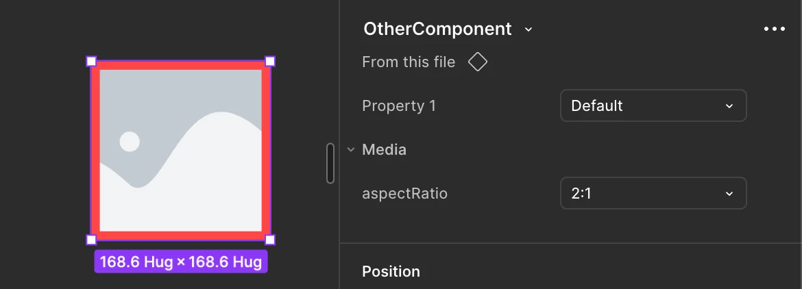

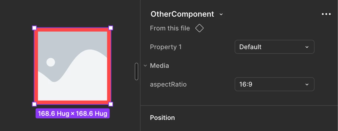

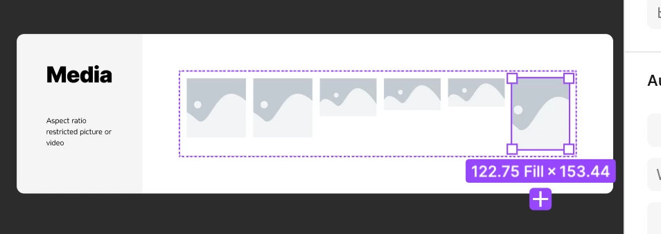

Parent component does not hug resize when nested instance swaps aspect ratio variant
When a nested component instance switches between variants with different aspect ratios, the parent component set to Hug contents does not resize to match the child’s new dimensions. The parent keeps its previous size instead of wrapping the updated aspect ratio.
Screen recording: https://streamable.com/e/q0fuwh
Another weird behaviour / a hack-fix that kind of works:
Detaching the parent component instance temporarily fixes the issue: the parent immediately resizes to the currently selected aspect ratio. After undoing (Ctrl + Z) to restore the instance, aspect ratio swapping works correctly for a short time, but eventually the parent stops responding to aspect ratio changes again.

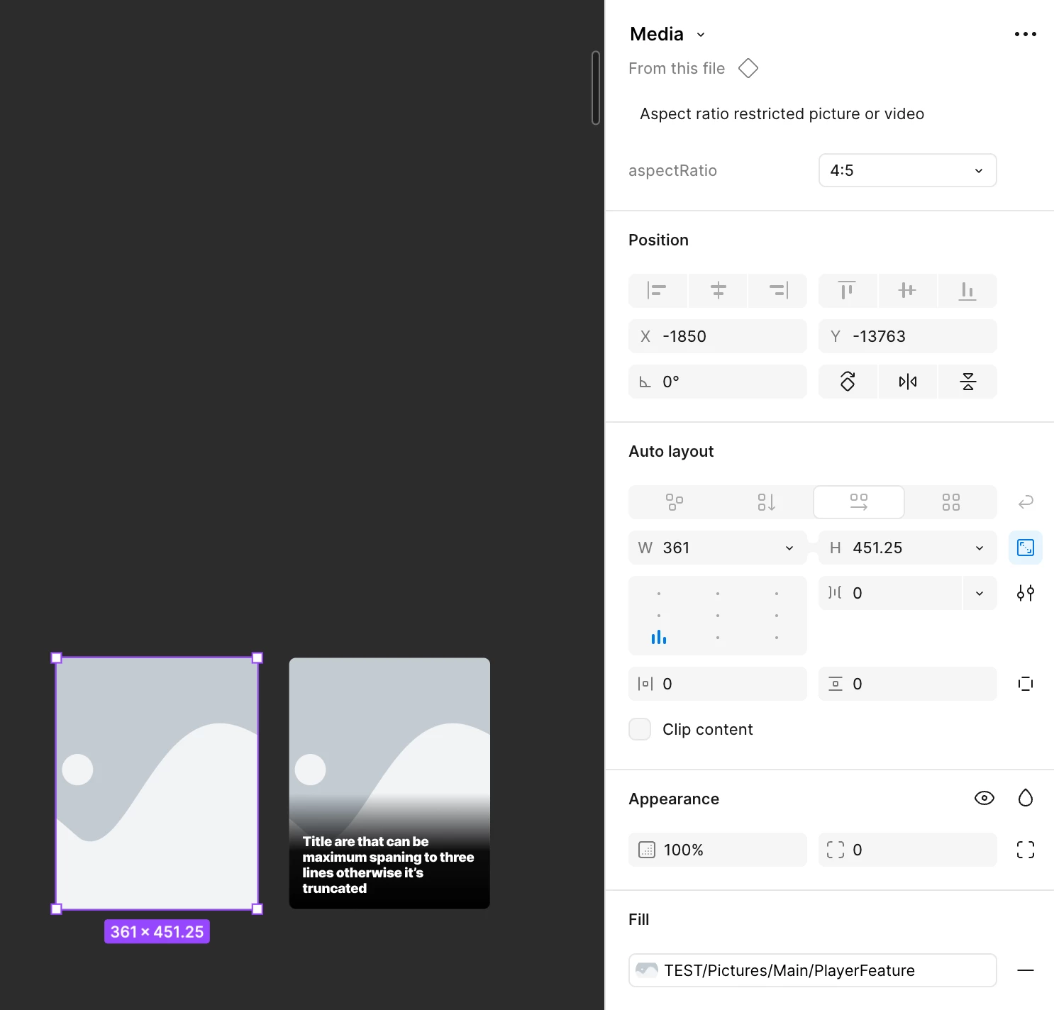

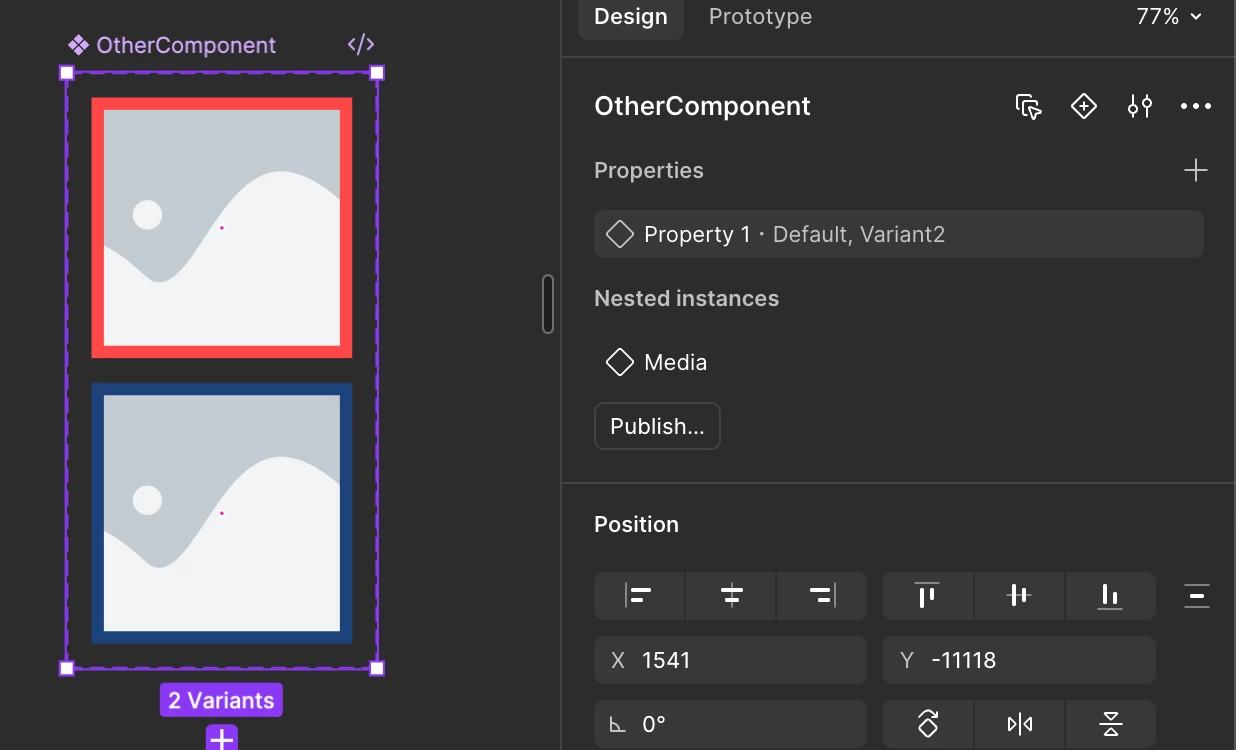

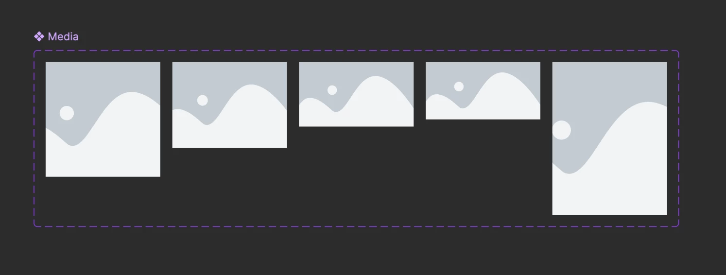

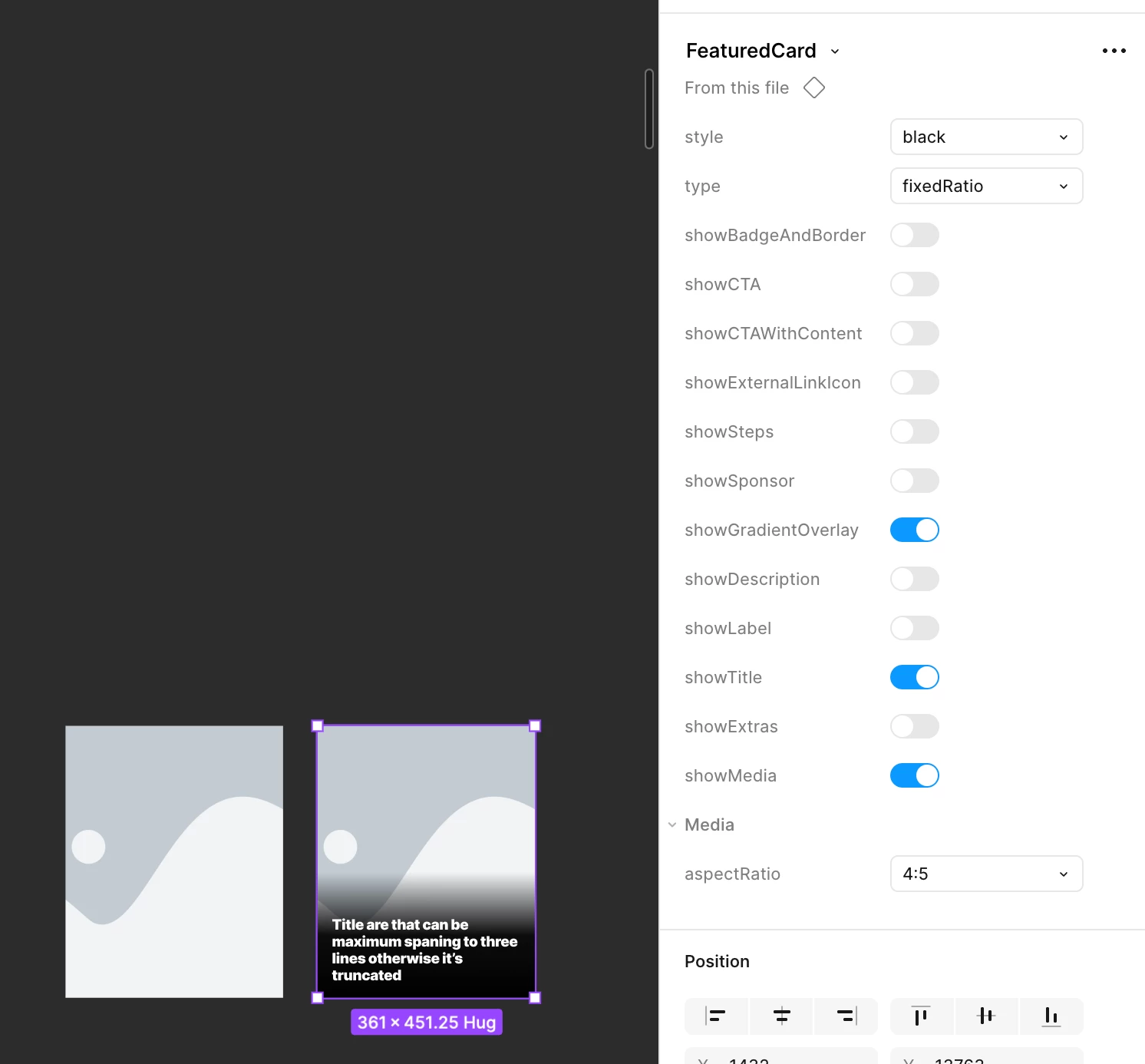

how did you do nested instances?
Edgaras_Benediktavicius
Feb 3, 2026 11:44 AM UTC
It’s simply a Media component that has aspect ratio props, and I nest it in FeaturedCard component
And the bug is that changing aspectRatio in FeaturedCard component doesn’t update the size of the FeaturedCard.
