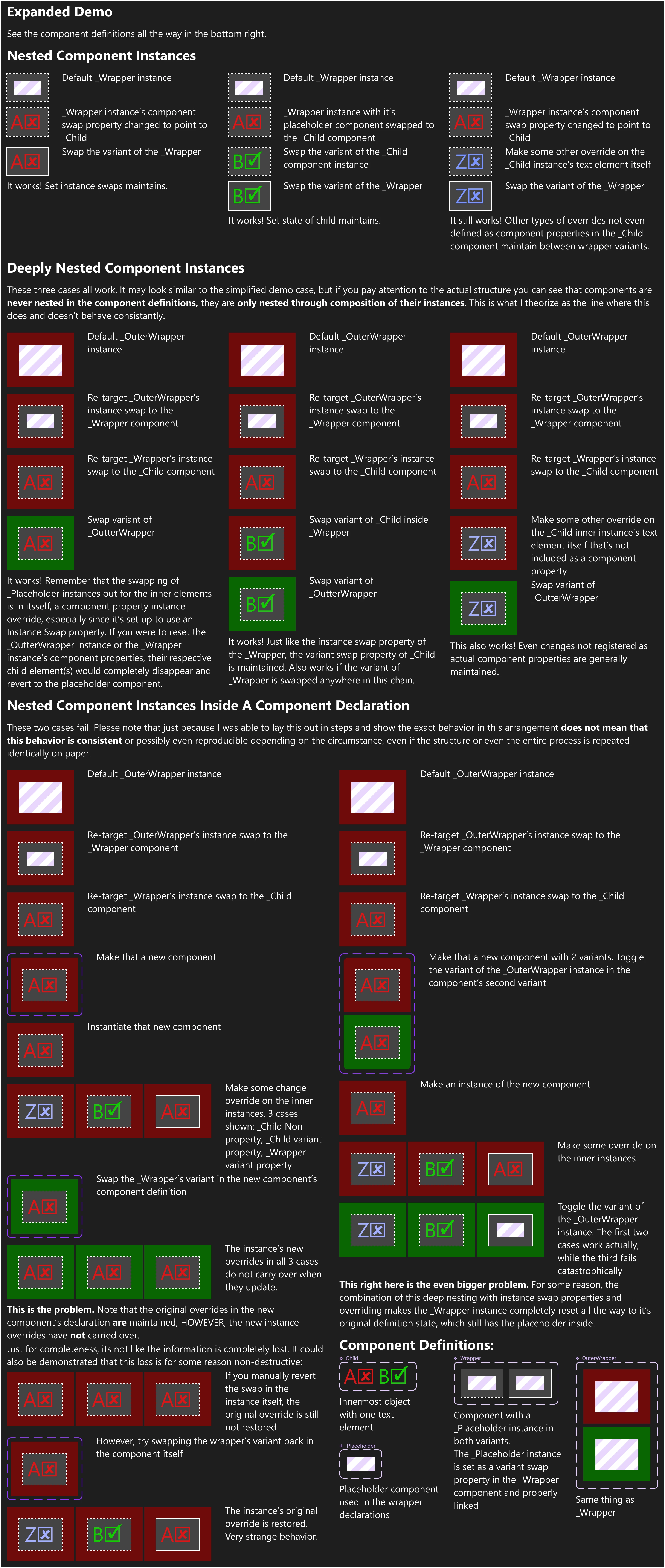

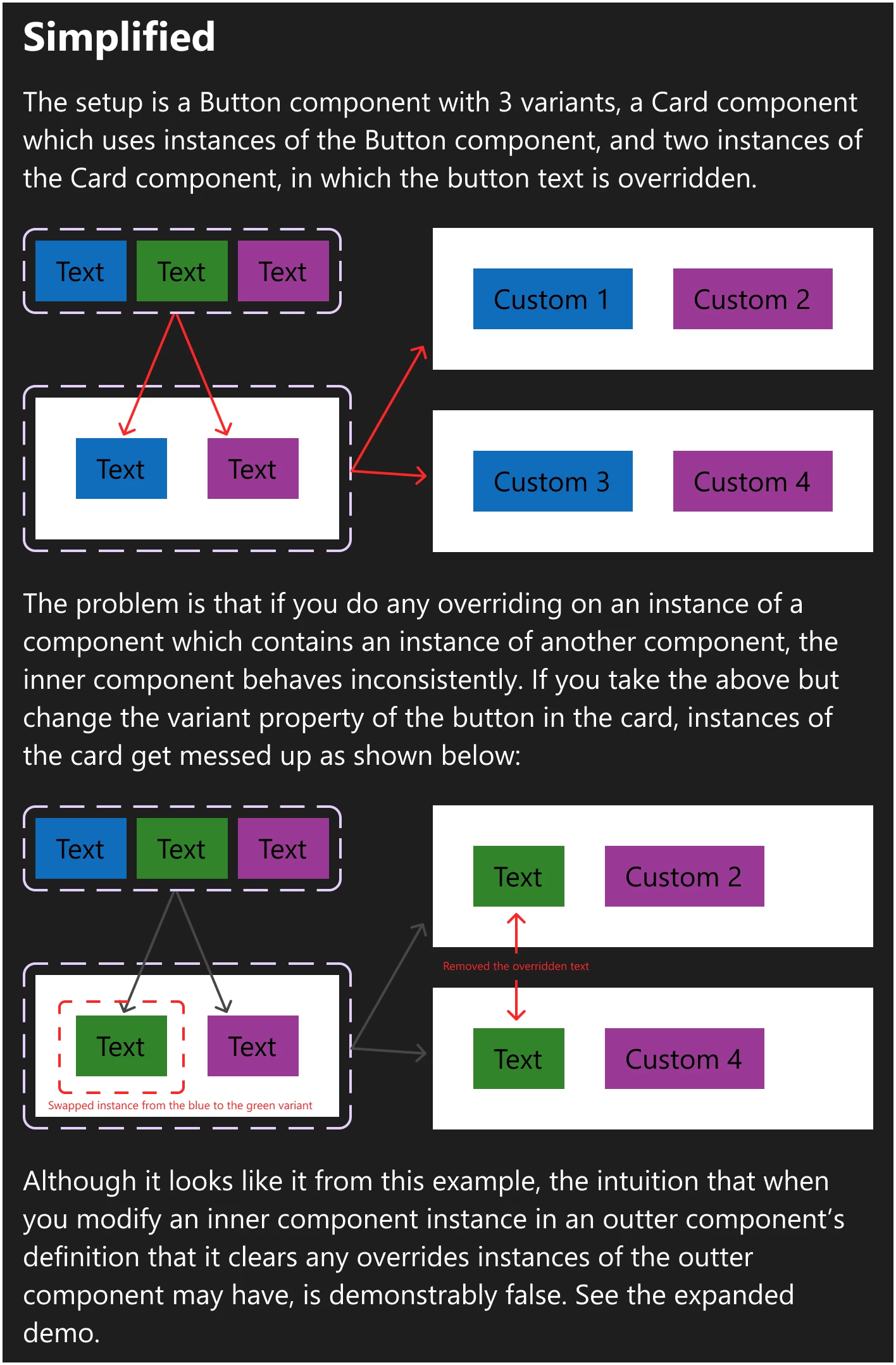

Demonstrations:
There are tons of demonstrations provided by people in the related threads, but I thought I should also show the results of my own testing as well. My test’s don’t fully express the problem, by any means, after all the whole point is that there’s both some things that are consistent and differentiable like the simplified demo below, all the way to the most complex demo in the video at the bottom where I couldn’t find any rhyme or reason at all.
Here is the simplified demo showing the problem in it’s simplest terms without involving variable modes or variants in the parent component, re-created from the demo video provided by ​@jnetzlr:
I have created an expanded version of this showing somewhat where the line is in one specific arrangement, but this is less consistent and repeatable then the simplified demo. If you follow the instructions precisely, you should see the same outcomes, but if you duplicated any instance or component definition at the wrong time, or swapped component sources, or potentially even if you did it completely identically, it may behave completely differently.

I want to also add clearly that when nesting components, the nesting can either be done by placing an actual instance in the parent’s component definition, or in an instance of the parent component via either the instance swap property with a placeholder, or using slots. The fact that there are all those three possible situations I think may be contributing to how irregular and frustrating this is. The issue presents somewhat differently or not at all in each of these cases and also differently with what your actual specific structure and usage of those are, potentially even involving prototype interaction or variable modes potentially driving instance swap properties.
