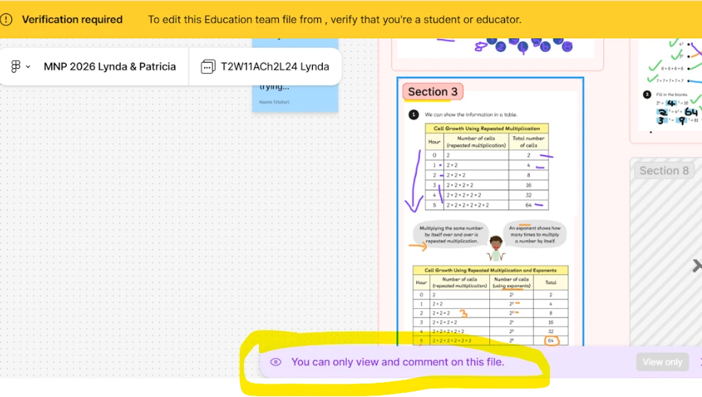

    1. I had one of my students yesterday, try to edit a board, and she told me the error message stated "you can only view and comment on this file.”  I’ve asked her for a screenshot.

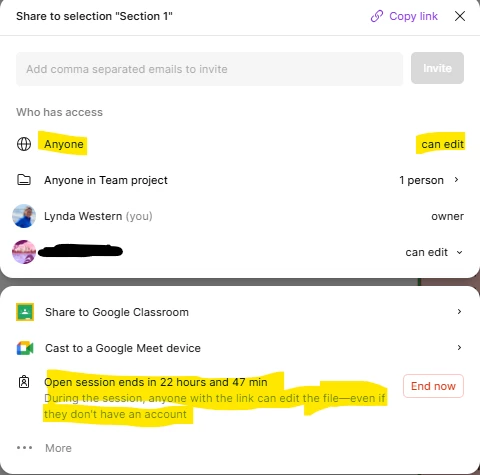

    This is really helpful. The error message your student received (you can only view and comment on this file) is a great clue. This message typically appears when the file's link sharing settings aren't fully aligned with the Open Session. Here's one thing worth double-checking:
    • When you open the Share modal and start the Open Session, could you confirm that the link sharing setting at the top of that modal is set to Anyone with the link – can edit(not can view)? The Open Session itself needs this to be set to "can edit", so that visitors joining via the link are granted editing access. If it's set to "can view," visitors will land in view-only mode even during an active session.

    Here is the screenshot from the student telling her that verification is required, and that she can ‘only view and comment on this file…

    Jul 2, 2026 1:03 AM UTC
    The information you’ve provided above is super helpful.  I’ve just double checked the settings at the top, and it’s all set to anybody can edit, and my student has just replied that she CANNOT edit the board.  The settings are as follows:
