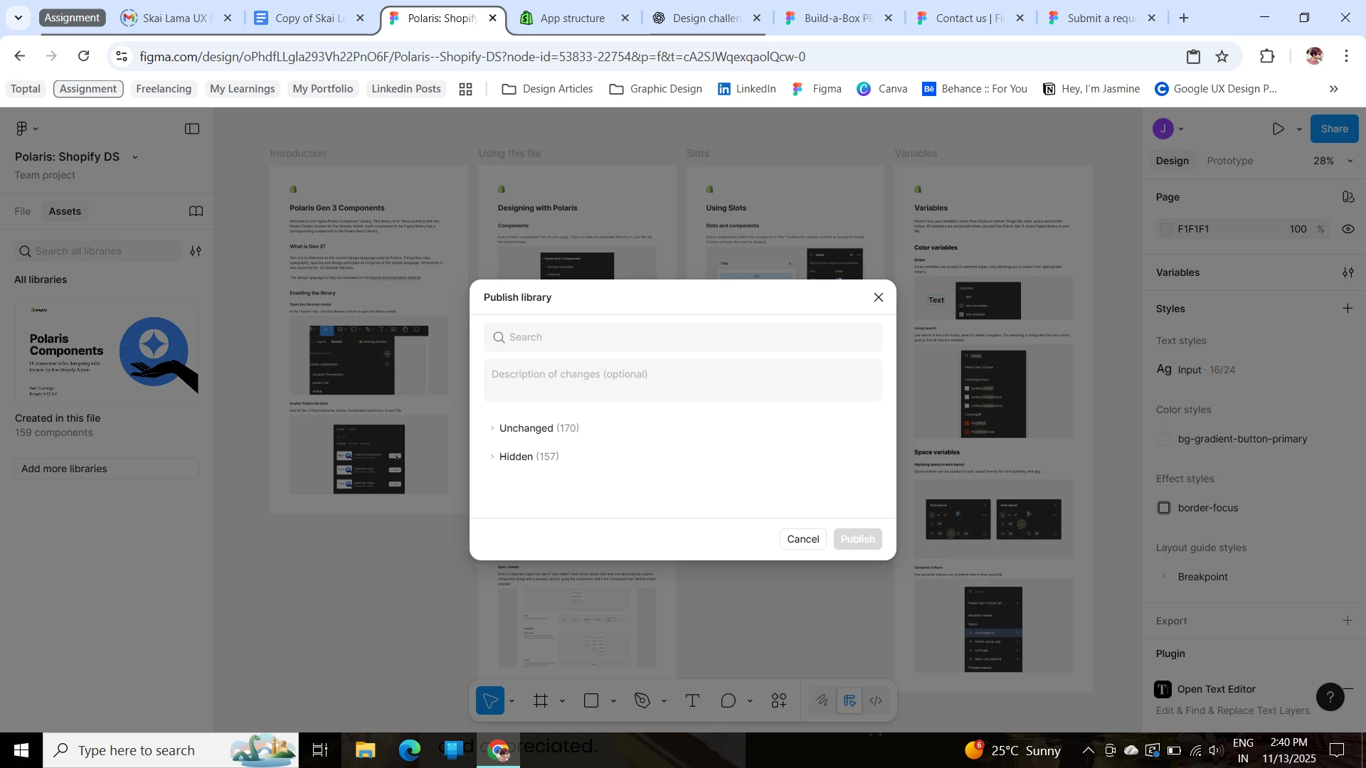

Not able to export Figma Design Library to Figma Make
​Figma Team please help me with this issue as I am not able to export Figma Design library to Figma Make as I am not able to get popup below publish popup to export to figma make. I have twice emailed the support team also, but no clear response has been provided to me yet for this bug that is happening. I am on pro education plan. Attaching screenshot below as well
No Export to Figma Make option while publishing library

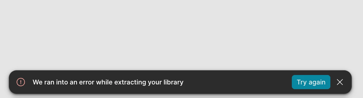

Same problem!

I shared this topic with the Figma Make team, and for ​@Jasmine Mahajan, ​@haozhang, and ​@Tiffany Lee, AI features in EDU teams haven’t been rolled out just yet, which explains why you’re unable to export. More info available in our Help Center article here: Why don’t I have access to AI features?
If you're a member of any other team on one of our paid plans, you should be able to transfer your library file to one of those teams with AI access and export to Make without any problems. That said, I would first check with the owner to make sure they don’t mind. Alternatively, you could create a paid team to access the AI feature and then access many more that you might find useful.
For ​@Henrik Lorentzen, this error typically happens when there aren't any components being published from the design file that can be used for styles extraction. Styles extraction relies on relevant components in the design file that can be used to infer how the design tokens are being used. Hope this helps explain!
