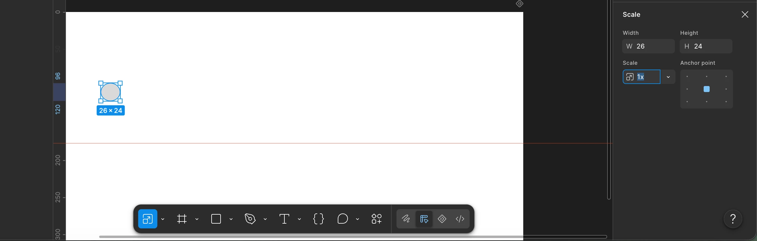

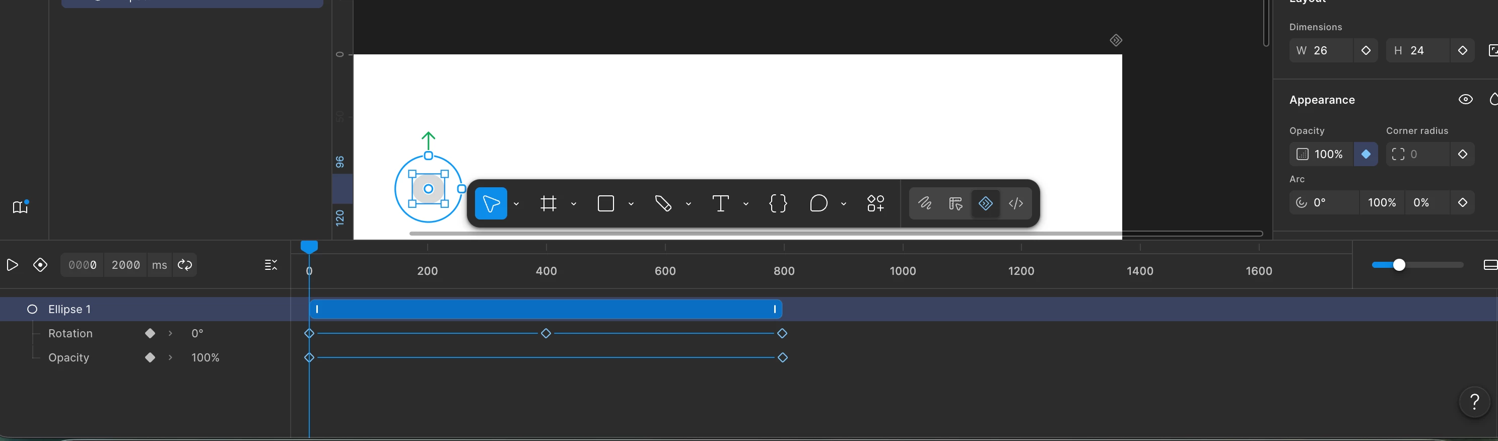

    Are you currently selected on Motion in toolbar at the bottom of Figma Design? The only way that the timeline and other Motion-specific options will be shown is if you’ve selected that rather than Design (similar to how if you select Draw or Dev Mode it will change what you see). If you click on Design, it will hide the timeline and also ensure that the K key command switches to the Scale tool.
    A screenshot showing Design mode selected as well as the Scale tool after hitting K.
    A screenshot showing Motion selected.
