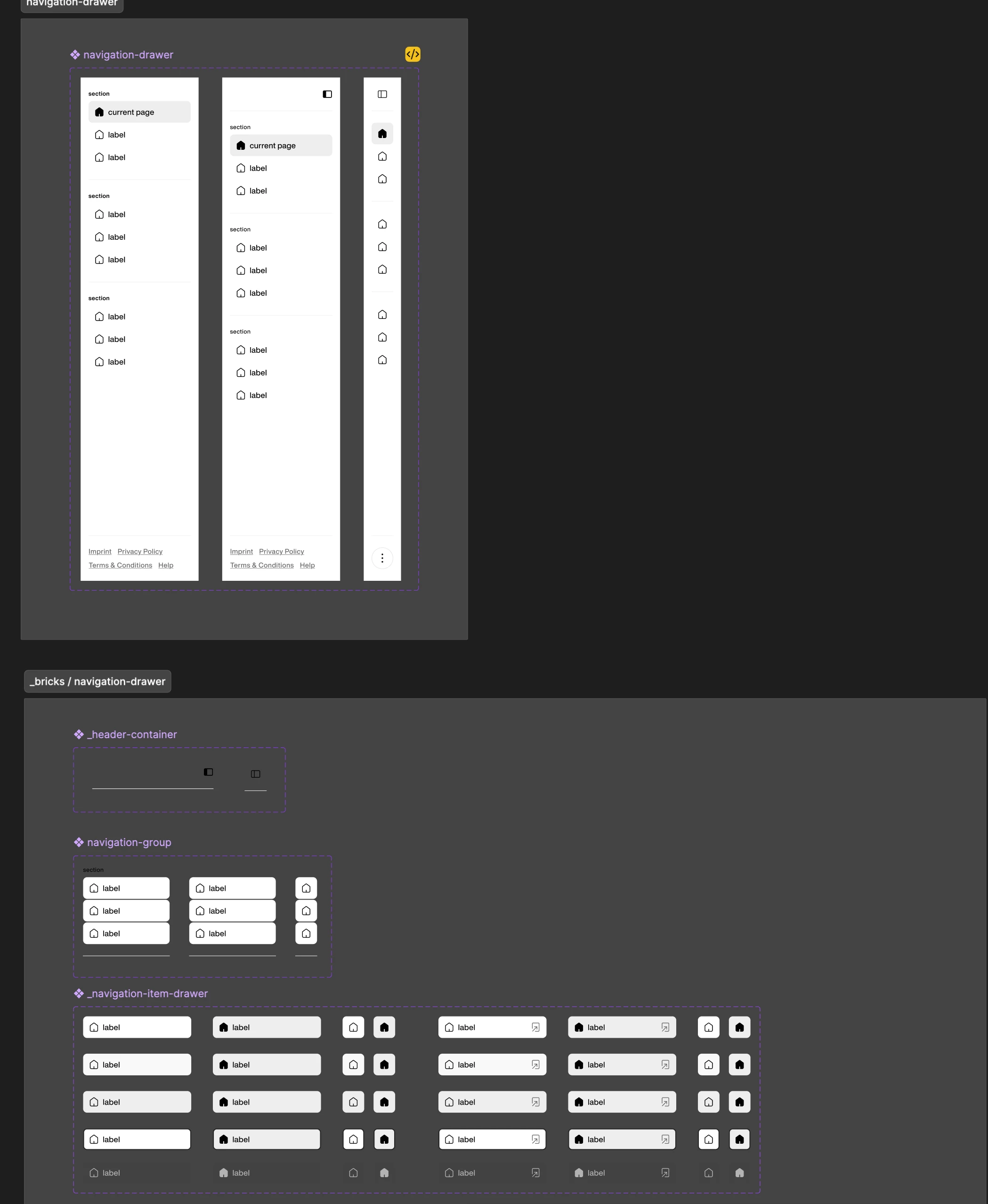

We're building a navigation drawer for our design system:
- A navigation item group component that contains a slot, so a dynamic number of navigation items can be placed inside it.
- This group is nested inside a drawer component, which itself exposes a navigation-section slot for further adjustments.
- The drawer has two variants: expanded and collapsed.

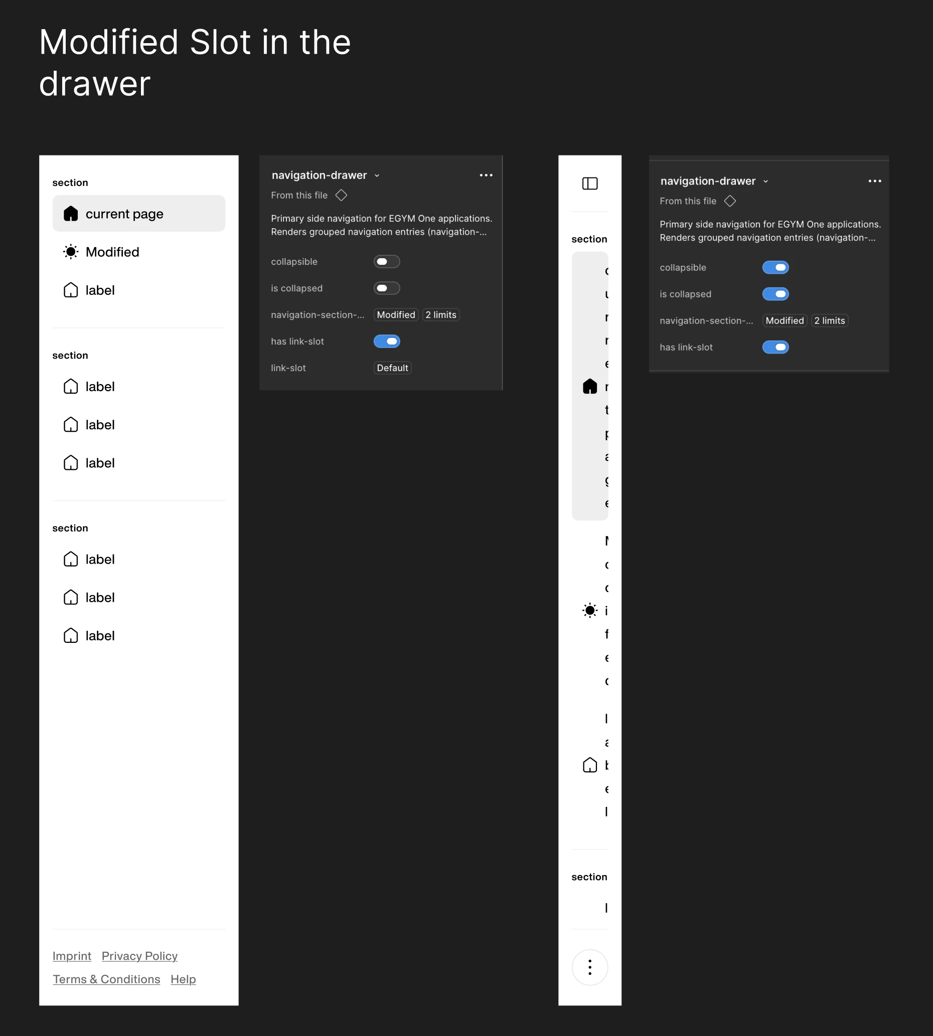

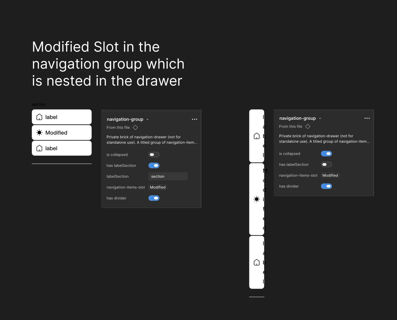

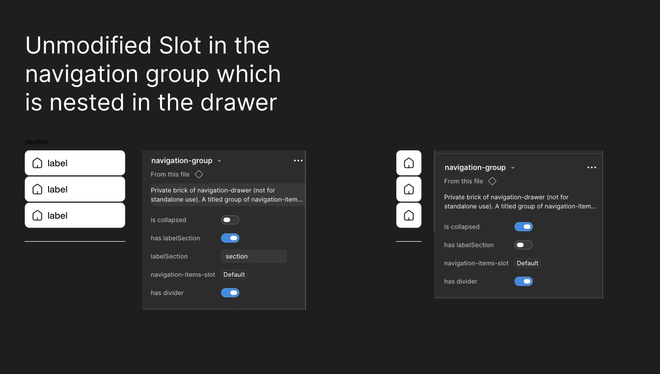

Variant switching only works as long as the slot content is untouched. As soon as I override anything inside a slot — e.g. add an item or edit text — switching the drawer instance to its collapsed variant no longer works. In the initial, unmodified state, collapsing works fine.

1. Flash / partial update? There's no freeze — the canvas stays responsive. The issue is better described as a state problem than a rendering one: once slot content has been modified in any way, the variant switch no longer carries that content over correctly.
2. Does the Properties panel register the switch? Yes, the variant property itself changes — but the modified slot content doesn't follow along.
3. Minimal un-nested case? Yes, it reproduces there too. Nesting makes it more painful, but it isn't the cause. See one of the nested components also shows the wrong behavior.
Which brings me to the core of it: slots currently don't handle modified component states at all. As soon as slot content is overridden (item added, text edited), it stops inheriting the properties and state changes of the component it lives in. But that's precisely the intended use case for slots — fill a component with dynamic content, then still toggle its states. Without that, slots aren't usable for real-world composed components like navigation drawers, list sections, or side panels.

Hey ​@Felix Pfahlert 👋 thanks for the detailed writeup and the follow-up screenshots — that made this really easy to pin down.
Based on the public docs, what you're running into is expected behavior. Once slot content is modified, it loses its link to the main component, so variant swaps stop affecting it. Nesting isn't the cause (your un-nested test confirmed that) — just more painful to hit. Documented under "Considerations" here.
Workaround: use variables instead of direct variant swapping for anything that needs to stay dynamic in a slot. Bind variables to the properties you want to change and switch modes instead. More on binding variables to variant instances.
