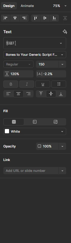

Missing Stroke, Effects, Appearence stc on the right panel.
Hello, my Figma slides were functioning properly yesterday. However, I just noticed that the right panel settings are no longer visible. The Layout, Appearance, and Stroke options have disappeared. Could someone please advise me on how to resolve this issue? I have selected my text, but I am only able to change the font and Fill color.

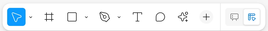

Hi ​@TrishT,
Just to confirm — did you happen to toggle to Slide mode in the toolbar?
To see the design-related options like Layout, Appearance, and Stroke, you'll need to switch to Design mode using the toggle in the toolbar.
If you have a Full seat and can edit access to the slide deck, you should be able to do this without any issue.
Here’s a helpful guide on how to enable Design mode in Figma Slides: Use design mode in Figma Slides
