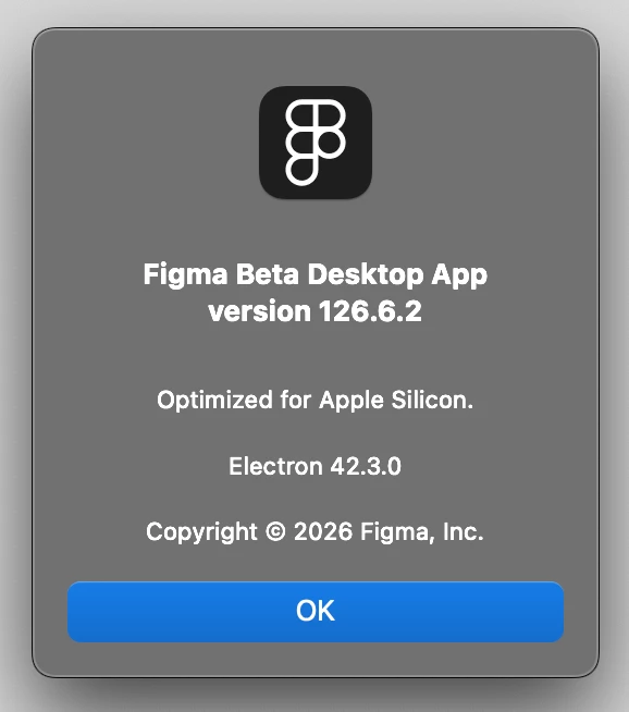

Our engineering team is actively investigating, and to help them move faster, there are two things I'd like everyone to try and report back on:
  1. Check your desktop app version, go to Figma menu bar > Figma > About Figma and drop the version number in a reply here.
  2. Try the Figma beta app, download it from Figma downloads and let us know whether switching to the beta resolves the font issue for you.
@jojobanks on rolling back, unfortunately there isn't a way to revert to a previous version of the Figma desktop app directly. The beta app is the best alternative path right now while the team works on a fix, so that's the one I'd point you towards.

FarshadY
Jun 3, 2026 2:22 PM UTC
Hi ​@Gayani_S
Thank you for following up on this issue. I installed the beta version, and the problem has been resolved.
Best regards,
P.S. After encountering this issue, I assumed that a very large number of Figma users would run into the same problem. However, the number of people who shared their experiences in this thread was far lower than I had expected.
I realized the answer when I had a phone call with one of my colleagues today. Even though we are using the same version of macOS, Figma app and the same Font, she is not experiencing this issue!
macOS: Tahoe 26.5
Figma Desktop App version 126.4.11
