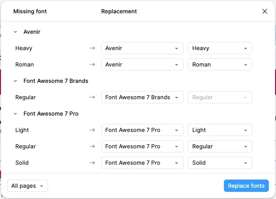

From just trying again, I went through this process:
First, I tried again to relink what Figma thinks are the missing fonts in the desktop app, but it still doesn’t work:

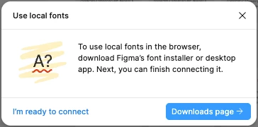

I then tried the web browser version in Chrome, but here, it wouldn’t even allow me to select Avenir from the list of fonts - it wasn’t in the list:

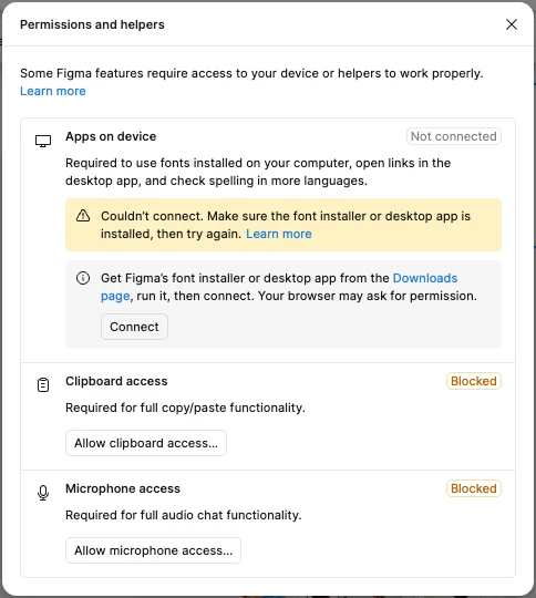

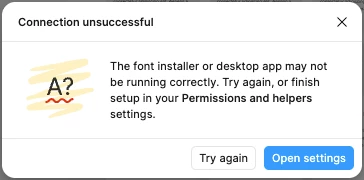

I then followed the blue link below to install the font installer again. I already have the desktop app and that’s working fine, so I just installed the font installer. Once that was installed, I went to try and connect:
But then I got an error saying that it thinks the font installer and desktop app aren’t running, so it couldn’t connect. But both definitely are:

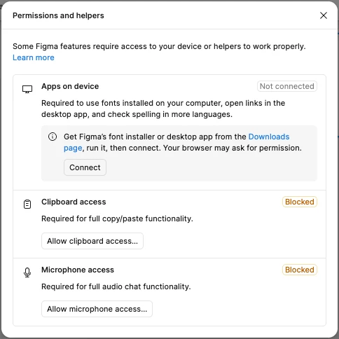

I even opened Figma’s settings and got the following:
So the fact that Figma won’t load these fonts, and browser version can’t connect to either the font installer or the desktop app, feels like it’s related.
