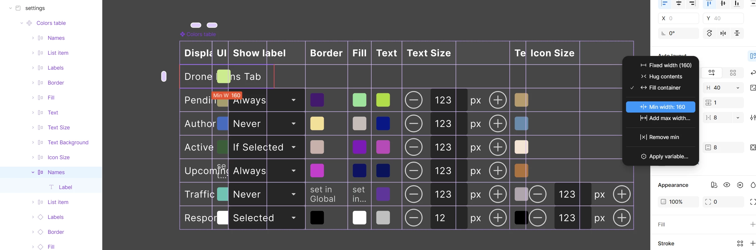

Here is how it is behaving currently, just to show what I’m currently taking issue with:
You see here the leftmost, selected item (“Names”) which has a min of 160 assigned but the colum is not respecting that; in the picture it is down to abt 60, the item you can see a bit in the background DOES respect the min, but this does not help if the column does not respect that.
