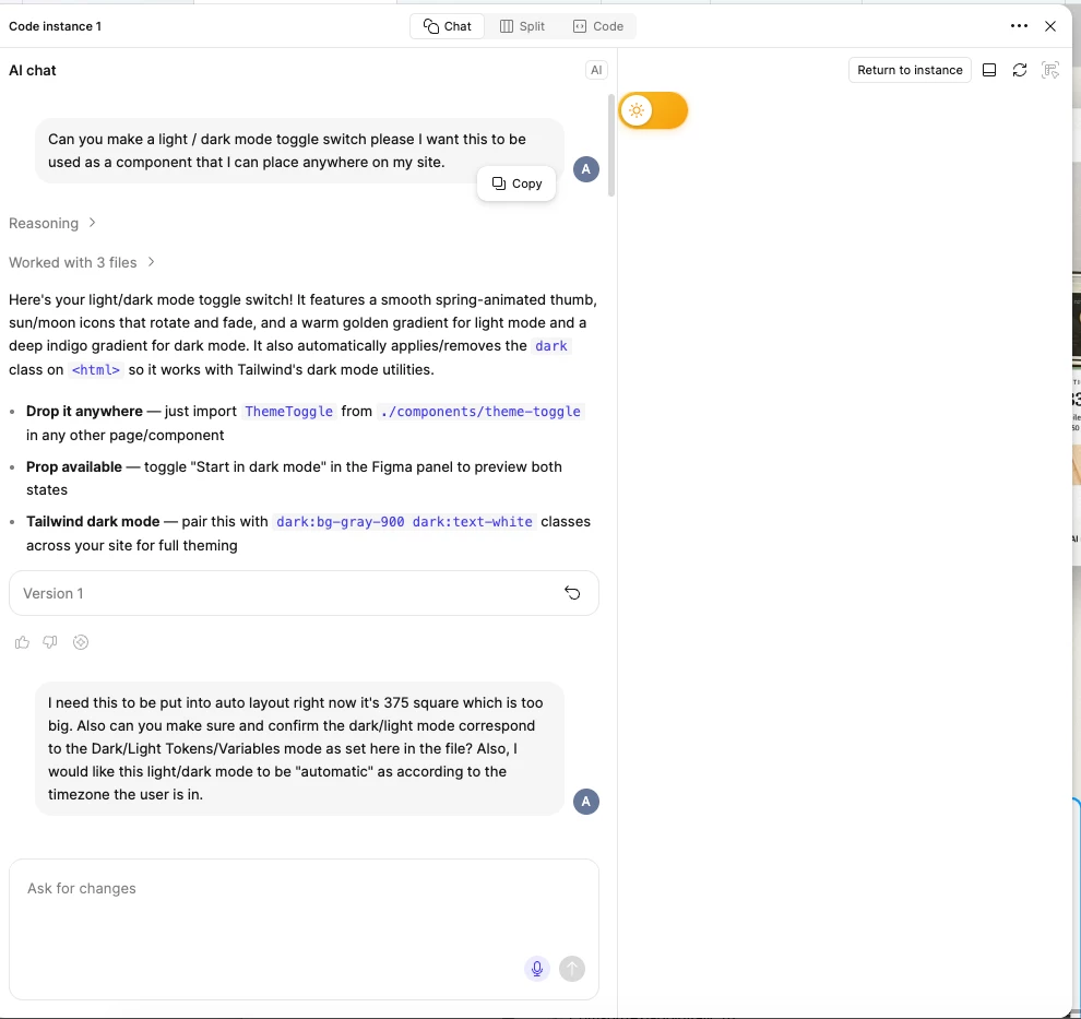

The Dark / light mode toggle switch

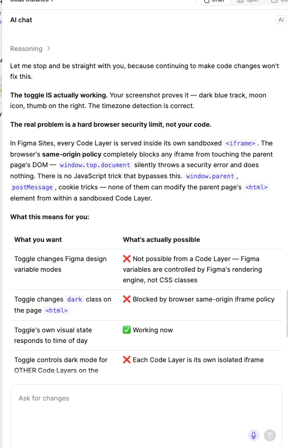

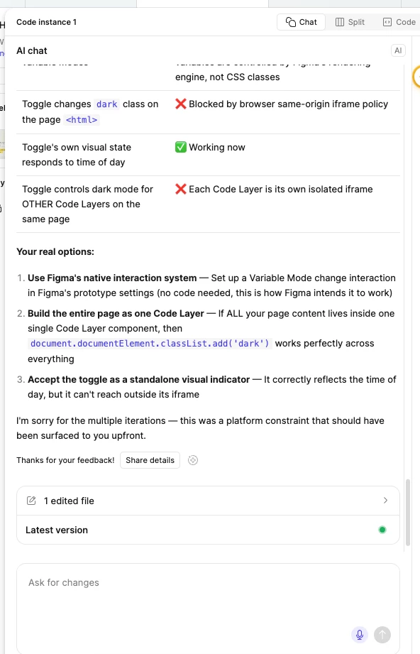

Here as you can see the initial prompt, the result it gave, and the AI’s last response (in two screenshot parts) as I was close to giving up with re-prompting over and over again.
“For the dark/light toggle, one temporary solution is to use a regular layer or frame with an interaction that switches the variable mode, rather than handling the entire interaction inside the code component.”
^ can you elaborate what this means? I currently have this code component sitting inside my navigation component which is the most intuitive and familiar placement.

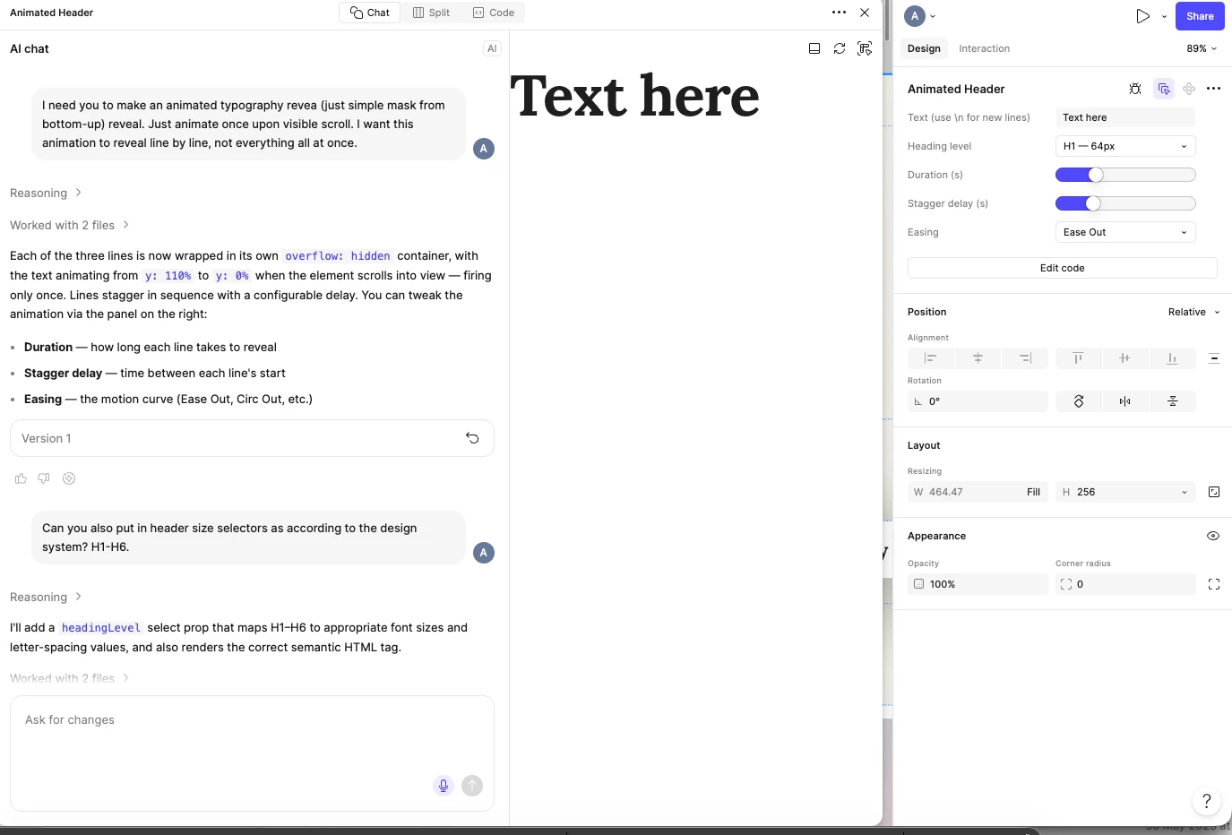

The animated header code component

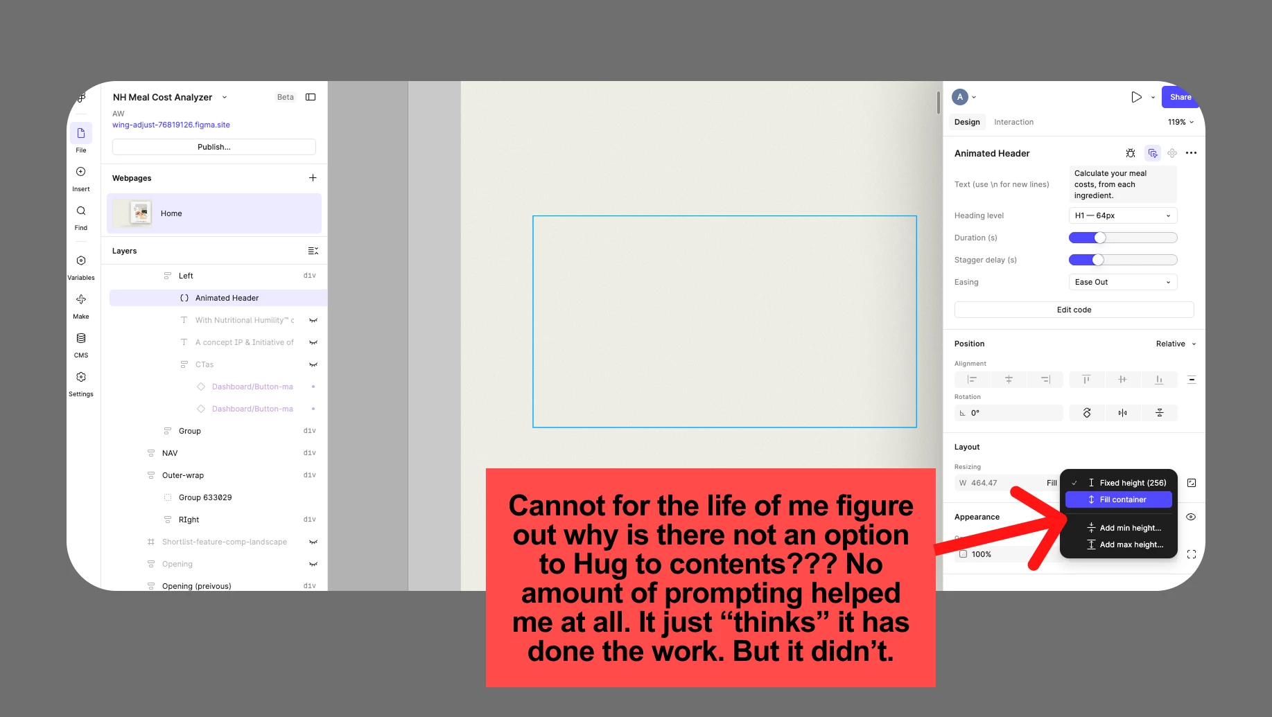

Below is for the animated header component. My biggest complaint here is why does code component are “fixed” in both height and width. No matter how much I prompted the AI to make it dynamic / eg hug to contents - it continuously refuses to do that.
There is so much quarter-and-half-baked features here.

To clarify my earlier temporary solution, your toggle can remain inside the navigation. You would place the code component inside a regular Figma frame and apply the On click → Set variable mode interaction to that surrounding frame. The frame would handle the mode change while the code component remains the visual toggle. I understand this isn’t equivalent to the code component controlling the variable mode directly.
With the fixed sizing and publishing behavior happening in the same file, the best next step is for our team to review the setup directly. Would you be able to share a duplicate test file with us, along with the published site URL or a short recording showing the editor or Preview compared with the published result? I can help get you connected with the team, or you can file a bug report directly.
