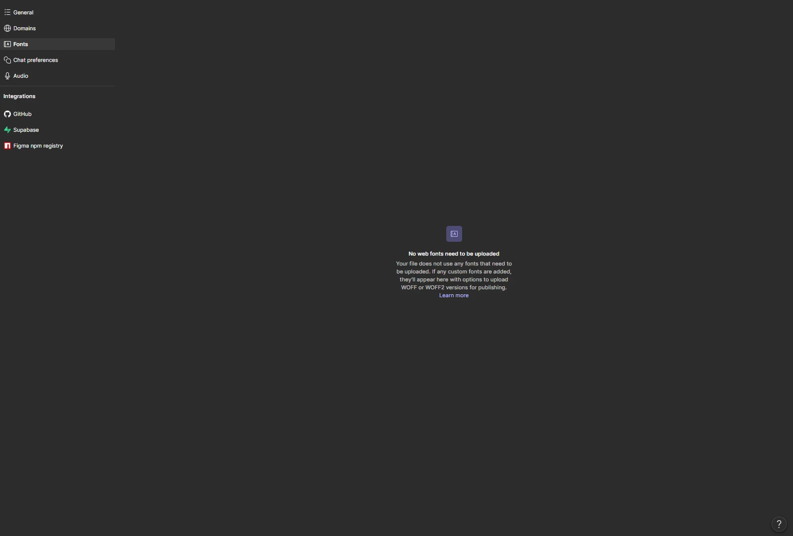

Screenshot of my lovely Fonts Tab:
This Image is always the same, before Publishing, after publishing, explicitly using Fonts with a local file asked

Hi, ​@JIkushirin - stepping in for ​@Jaycee Lewis. Thank for the screenshot and further details!
You shouldn’t actually need to upload or locally provide Google fonts as those should be readily available within Figma Design as font choices. If you open a Figma Design file and edit a text layer, are you able to set the font to Inter or another Google font? Normally, you should be able to just tell Figma Make to use Inter or another font we provide so you don’t need to locally host it.
