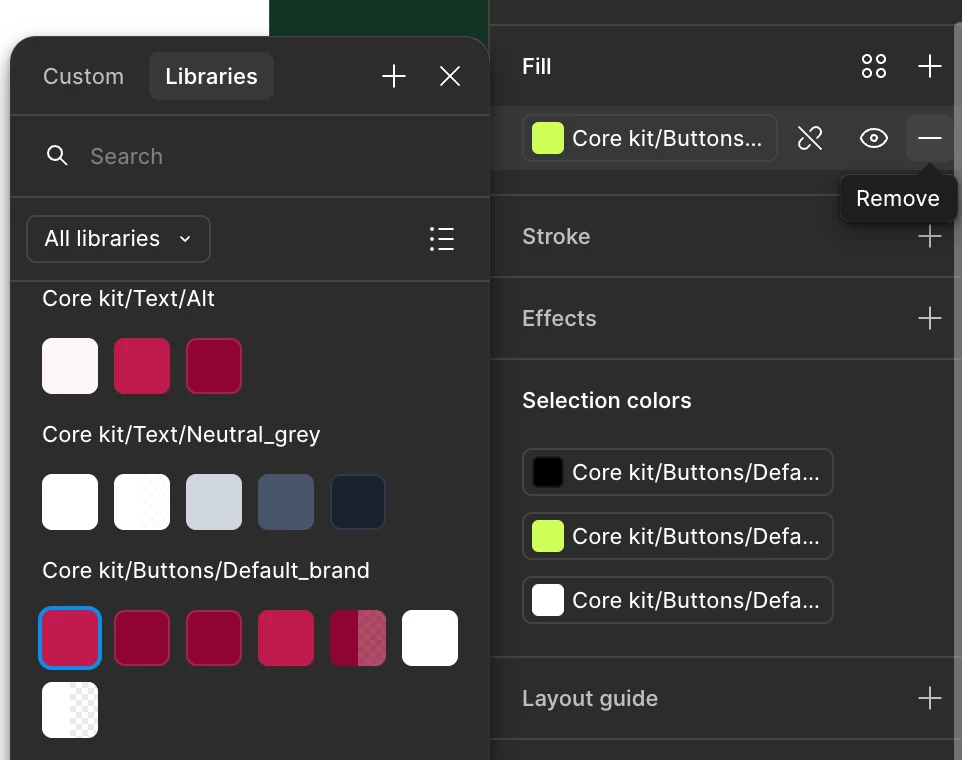

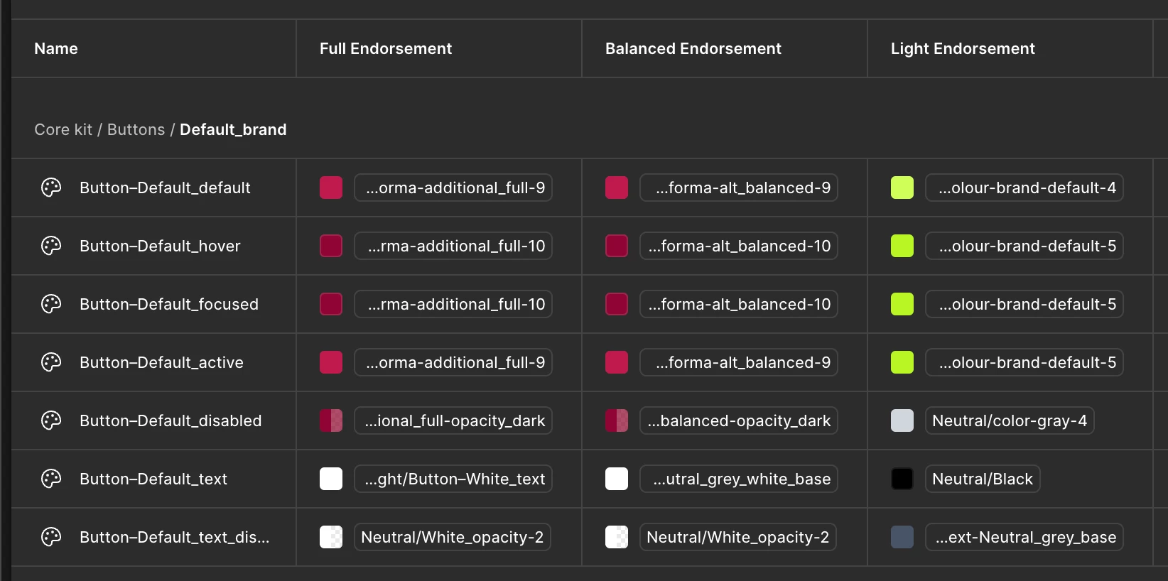

When switching between variable modes in Figma (e.g., Balanced Endorsement, Light Endorsement, Full Endorsement), colours applied to components (e.g., buttons) do not update correctly. Some elements retain the wrong colour despite the linked colour updating correctly.
Steps to Reproduce:
Hard to say as this was working correctly until 22nd August
Expected Behaviour:
All component fills and text colours should update consistently to the values defined in the selected variable mode.
Actual Behaviour:

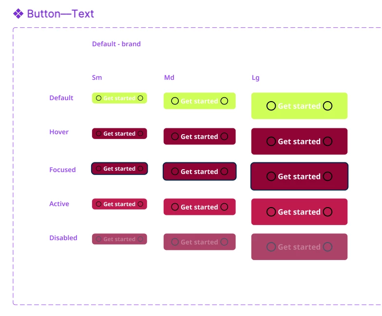

  • Some fills remain stuck on a previous mode
  • Variables show as linked correctly in the right-hand panel, but the applied colour doesn’t match the mode
  • In the component preview, some components display the wrong colours
