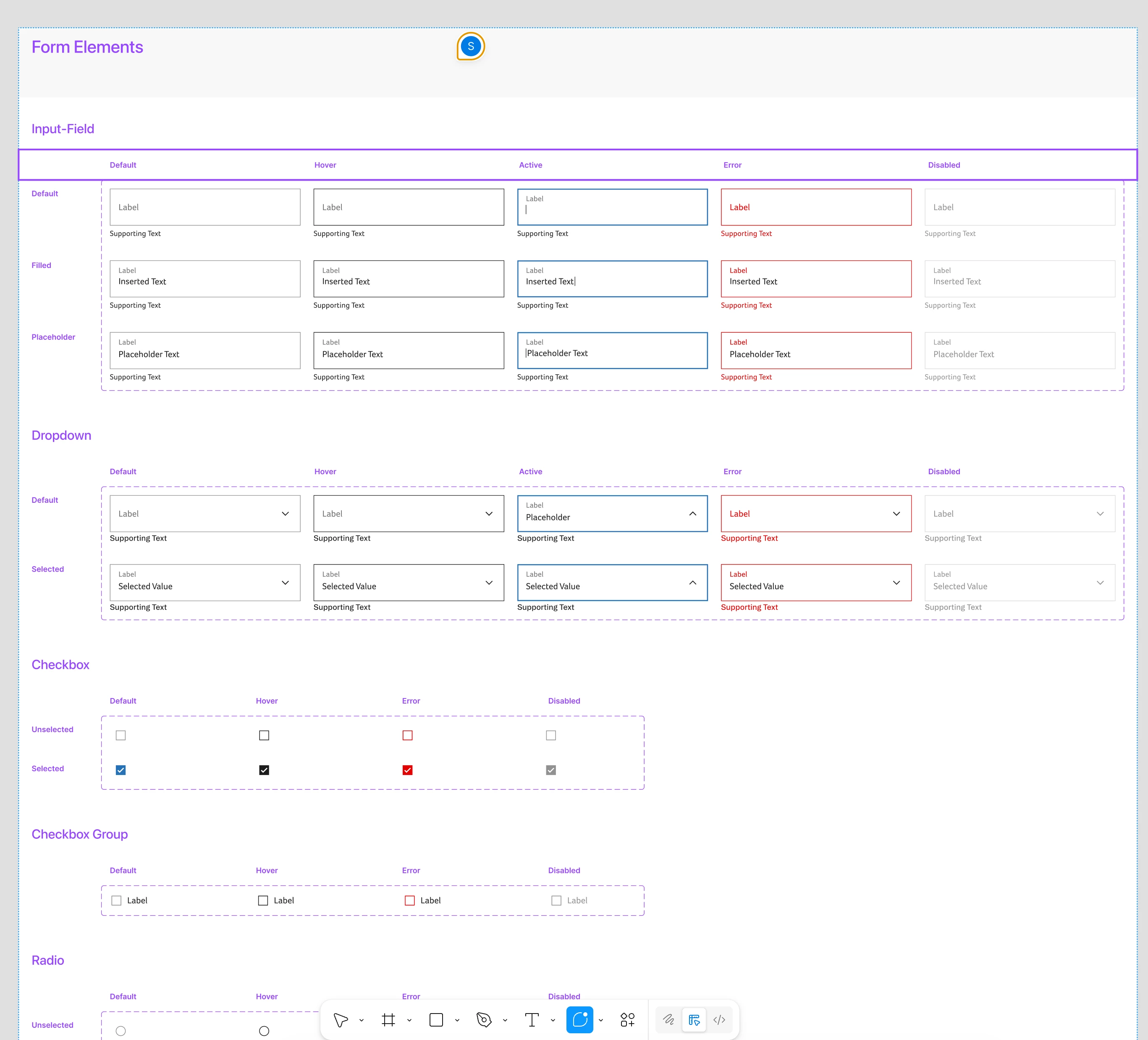

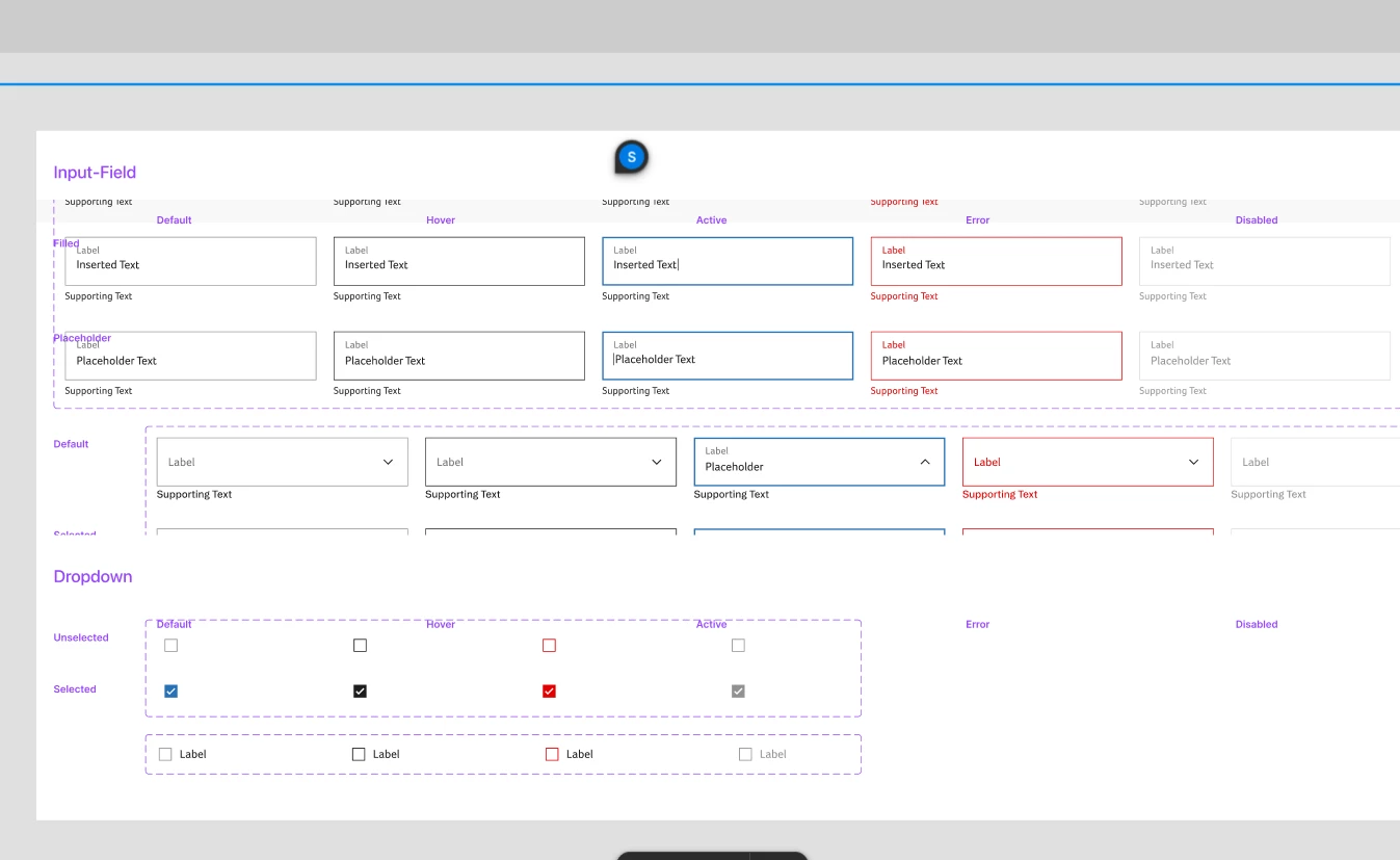

Hey there,
we’ve experienced some layout issues over the last couple of weeks between our design and dev team. Multiple developers commented, that some designs seem to be broken – however they are displayed correct when our designers enter the figma file with their admin account.
I’m not sure how far the discrepancy goes, but what I can say is that it has to do with auto layouts that seem to get stuck in dev mode. If designers update components, the auto layout within the file updates as well. However, sometimes the same component in dev mode looks like it is stuck in a fixed size frame and will be cut at the edges. The only solution that fixes this problem is, that you delete the auto layout and create the same auto layout again.
As mentioned, this is pretty annoying as there is no chance for our designers to see the problems that the devs are experiencing. And on the other hand if the layout is not clearly a mistake, the Devs might as well implement components where they might not see everything due to this issue.
I hope this bug will be solved soon.
Attached you see a comparison between what the designer and what the dev experiences in the same file (in this case, there are no branches involved in the figma file)

Thanks again for the detailed explanation and the comparison screenshots, those are really helpful. Looking at what you shared, it seems like the layout is updating correctly in Design, but in Dev Mode some components appear “stuck” and clipped until Auto Layout is recreated.
