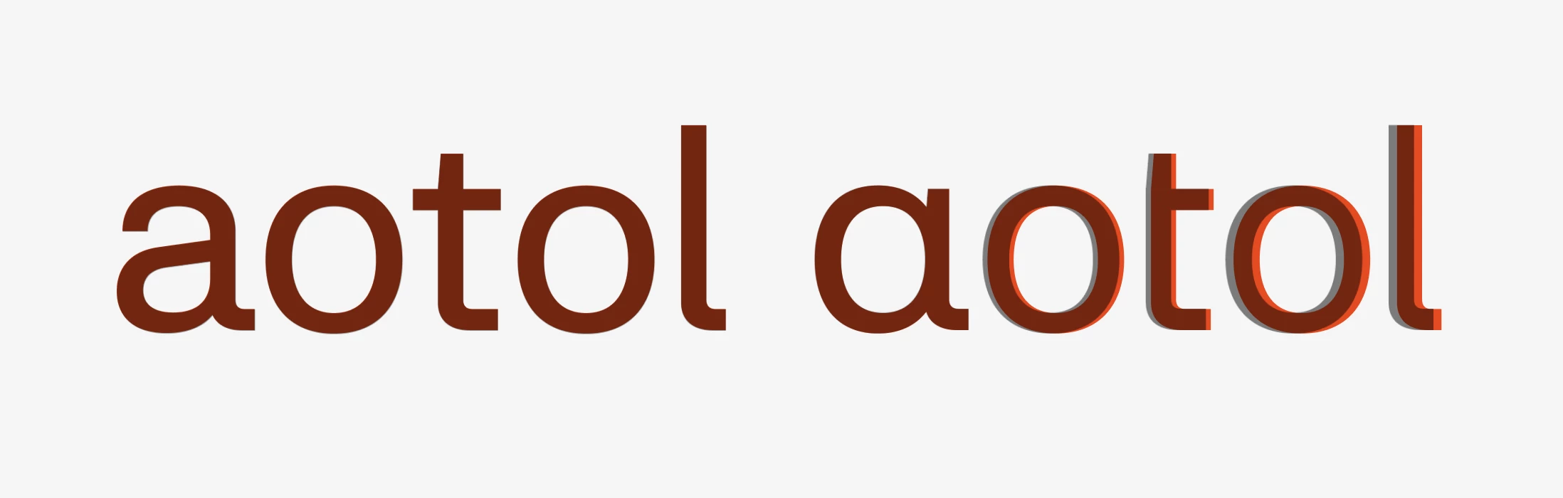

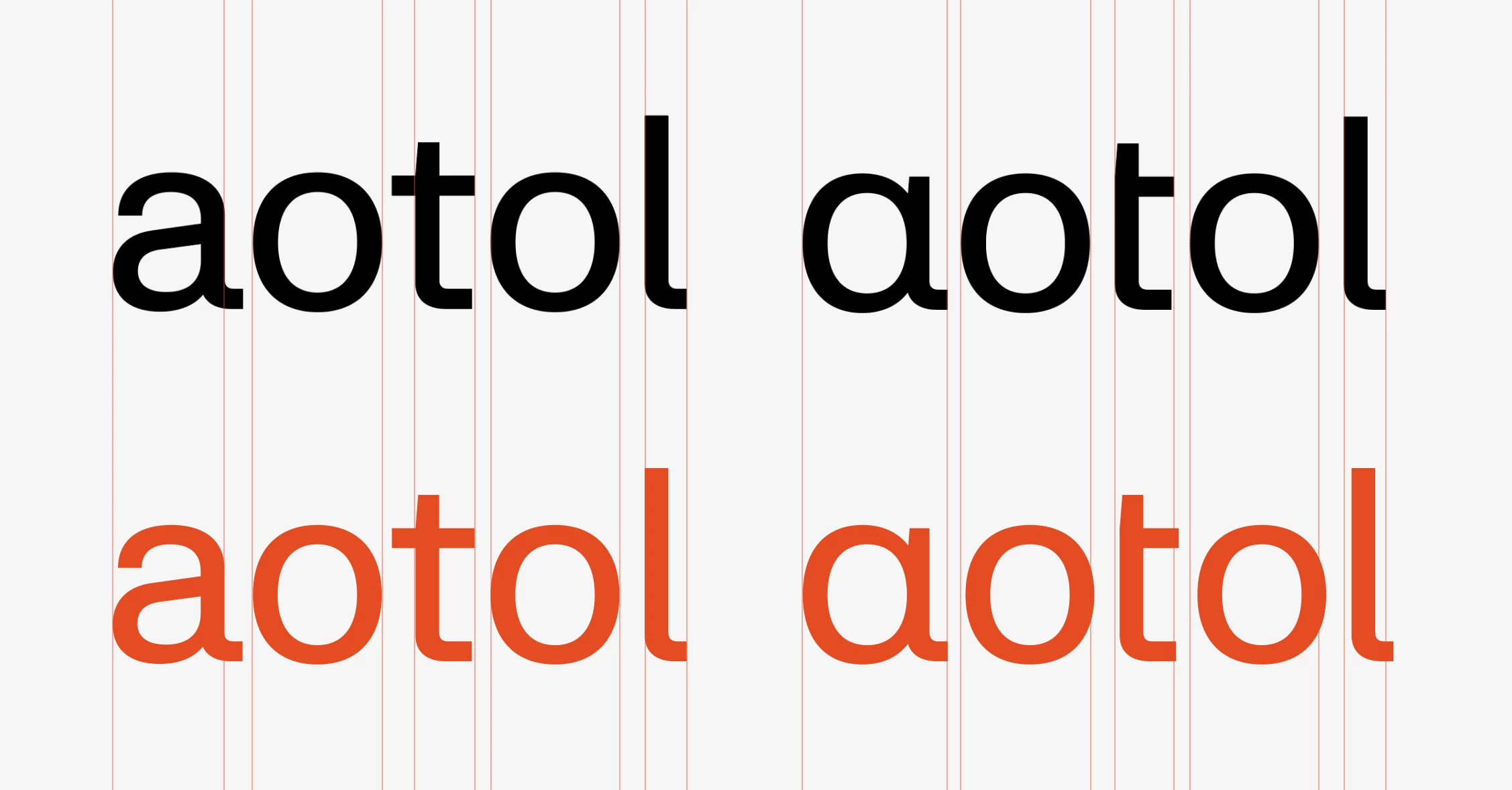

I have included an image below which shows text rendered in InDesign (with the typeface’s default kerning options) in black and the text rendered in Figma in red. In the left example, the characters are spaced exactly as expected using the kerning from the type designer. They are the same in both applications. In the right example, the red text rendered in Figma no longer applies the kerning found between the alternate lowercase a and o, or the alternate lowercase t and lowercase o – even though these kerning pairs are present in the typeface and render in InDesign.
If I overlay the black and red text samples, the left example (no alternates) aligns perfectly, whereas the text containing alternates does not.
