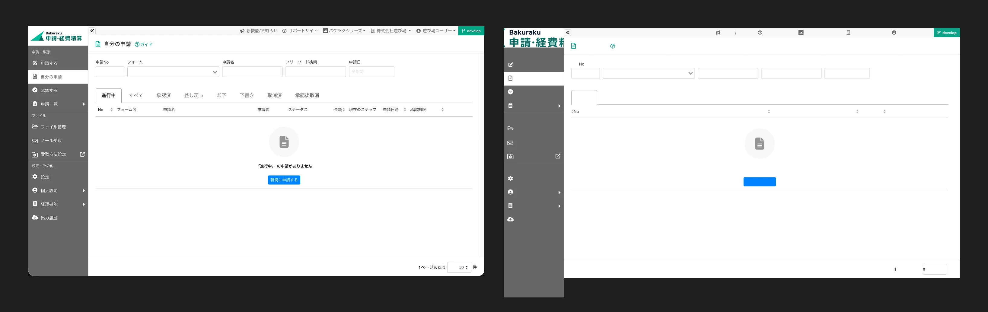

Thank you for your response! I've attached a screenshot showing the issue. As you can see, the left side shows the actual product screen, and the right side shows the Figma output generated via Claude Code with Figma MCP. The difference is quite significant.

Helvetica Neue is selected in the generated text layers. This is likely being applied as a fallback, since Helvetica Neue does not support Japanese characters.
The fonts we are actually using for Japanese text in our product are:
- Hiragino Kaku Gothic ProN
- Hiragino Sans
Are you seeing this across all Japanese fonts, or only specific ones?
From what I've tested, this occurs across all Japanese fonts — it appears that Japanese fonts are not being assigned correctly during the generation process.
Does the issue persist if you manually change the font in the text layer?
Yes — when I manually assign a Japanese-compatible font (e.g. Hiragino Kaku Gothic ProN, Hiragino Sans), the text renders correctly. So the issue seems to be that the MCP tool is not applying an appropriate Japanese font during generation.
