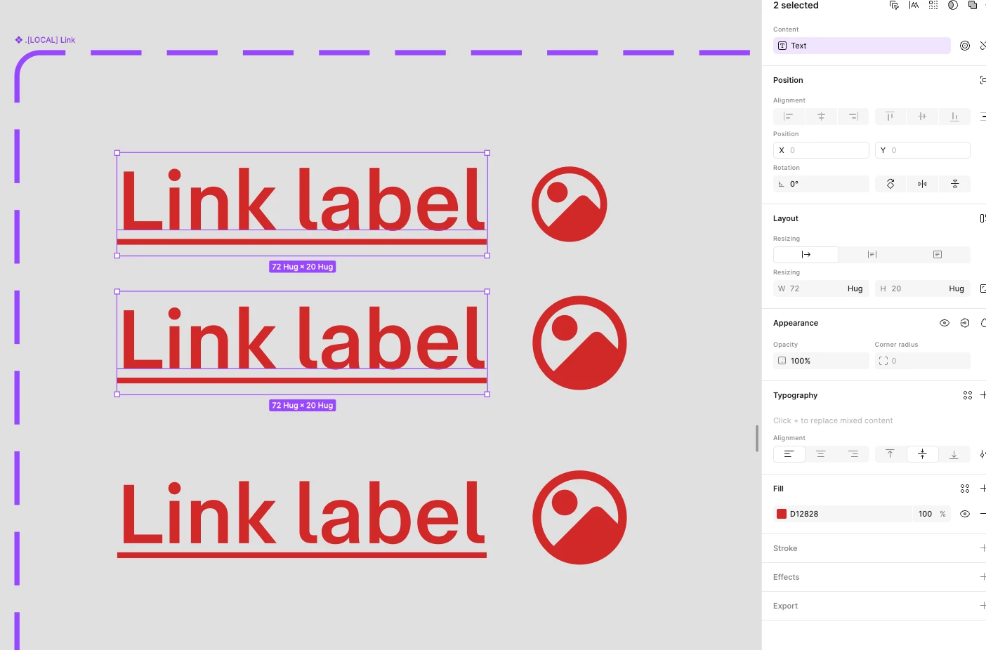

Issue with Text property overriding text styles in component sets.

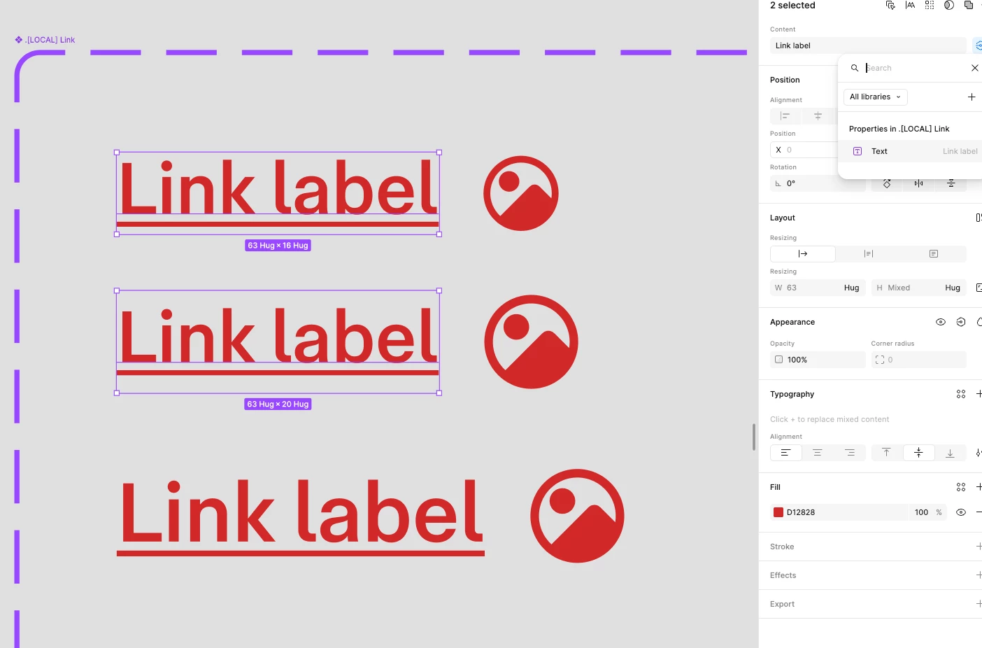

Hey so I’ve noticed that if I create a component set, which has different size variants and for each variant I have defined different text styles sizes utilising variables. If I have for instance three different link component sizes in the component set and each link variant is set to a a small, medium, large text style. What I’ve observed is that if It apply the ‘Text’ property to the text layers. For some reason they all ignore what they’re designated text style is and all adopt the same large text style. No matter what I do I can’t seem to stop it from changing the text style?

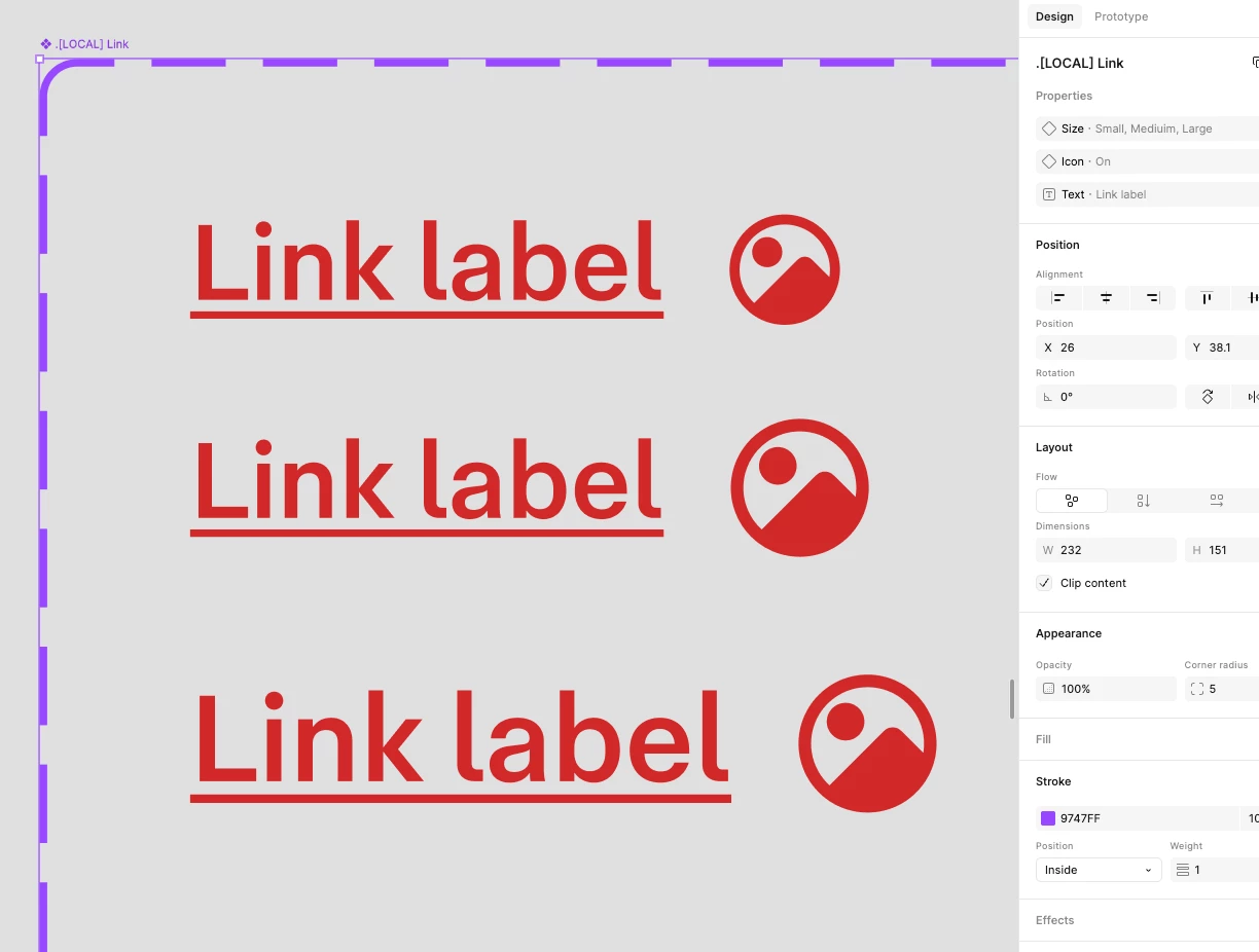

Apr 23, 2026 11:26 PM UTC
So I’ve noticed that what triggers the issue, is if I apply the underline style as an override on the variant after I’ve built out all the variants. I was of the impression that I would be able to apply the underline styles independently, but it seems I still have to create seperate underline/non-underline text styles for this to work. Very odd behaviour.
