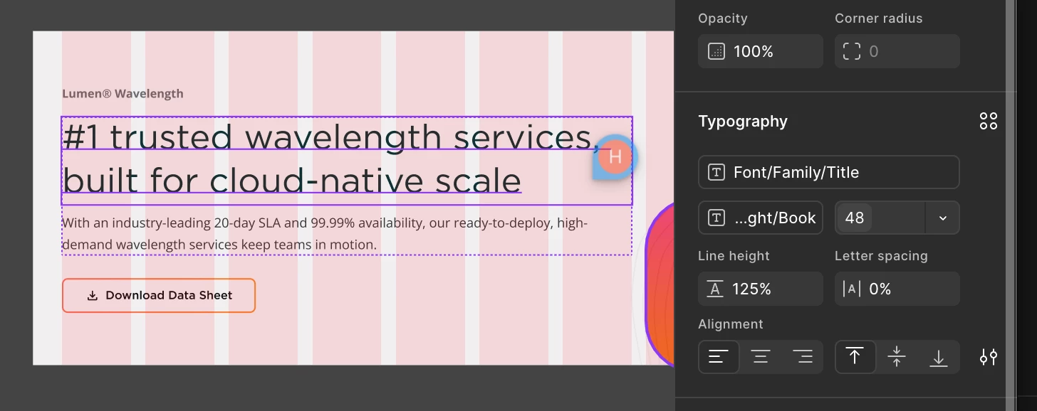

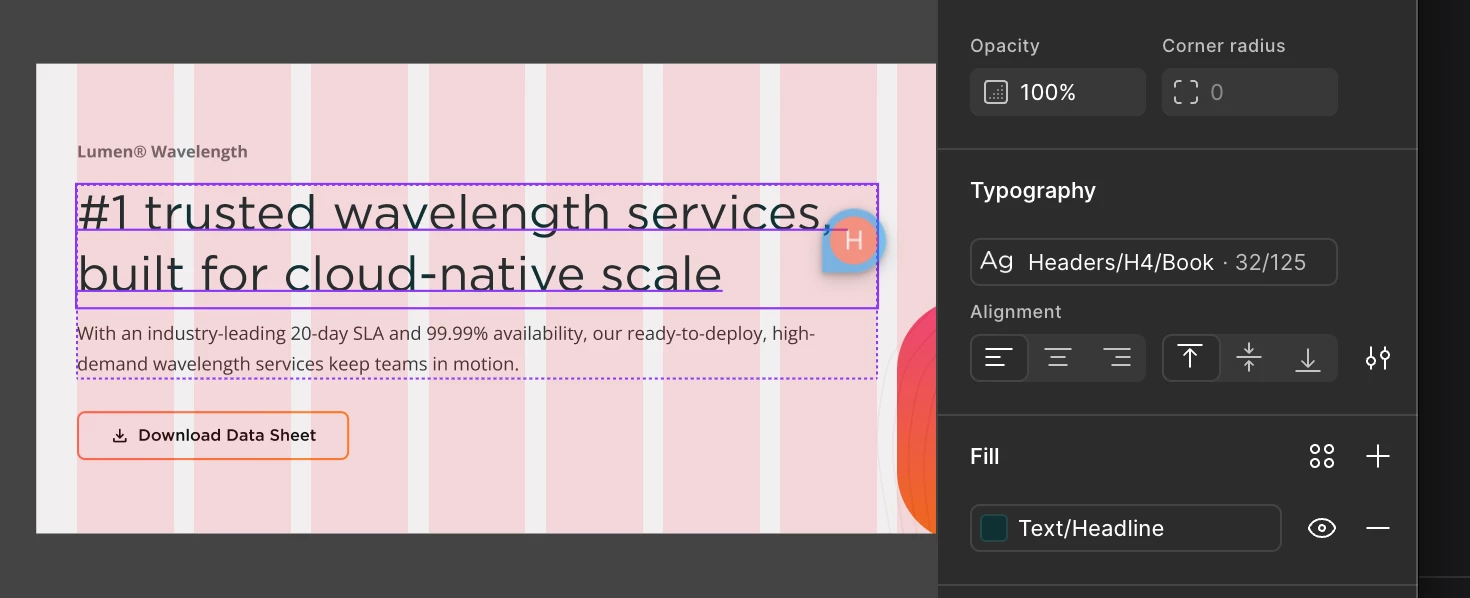

Patrick Grady
Apr 15, 2026 4:50 PM UTC
I also have this problem!
Please make it so font sizes in the right hand palette reflect then current font size instead of the default/initial size.
It’s annoying to disconnect/reconnect to verify the font size.
Incorrect
Correct.

Patrick Grady
Apr 17, 2026 2:10 PM UTC
​@adamsmasher thanks so much for the response!
This is in Figma Design, specifically when you have variables and modes handling font resizing for different viewports.
