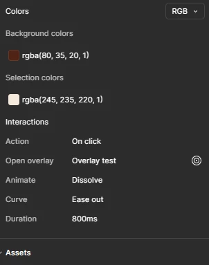

Is it possible to get the background color/position of prototype overlays inside rest api/dev mod? (without plugin)
Hello, im working on a reading of overlays interaction from the Rest Api but im not able to get the background-color/Position of it (see the picture first picture)
It’s also unavailable on dev mod :
We can cleary see the animation, duration etc but not the background/position...
Am I missing something like it’s available somewhere? Or maybe is it a bug? But I can’t figure where to get this datas beside using a Plugin, and my goal is to mot use a plugin at all
here are the only datas I can get :
