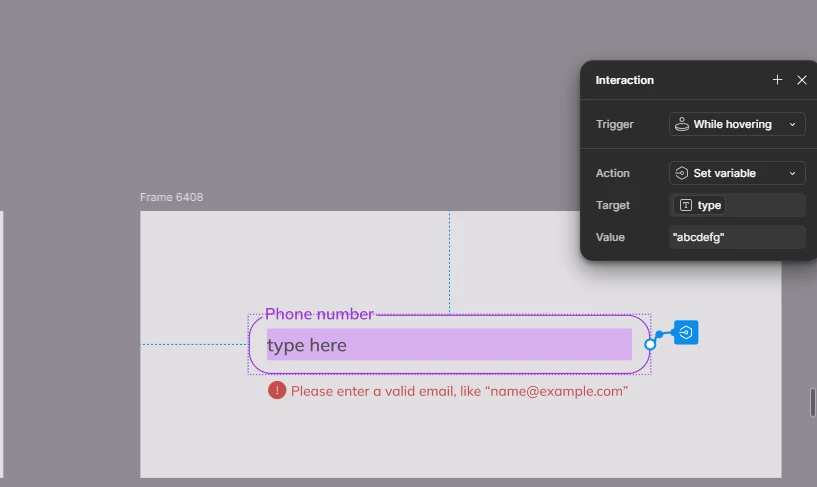

I made a totally logical variable/conditional setup and it doesn’t seem to work on desktop prototype:
Test-input-visible” is a boolean variable property, while “text-input” is a string variable property

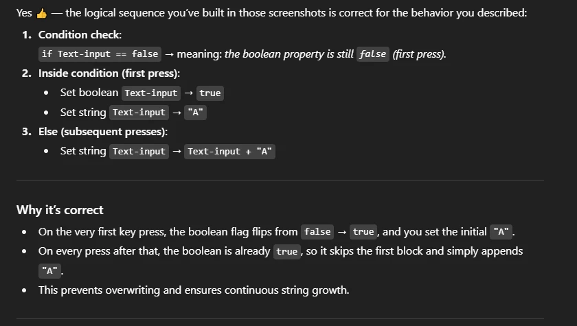

So I thought I was wrong about the set up so I asked Chatgpt:
Chatgpt’s prompt response
So, just to confirm if I made a mistake, I make a simpler interaction to test it out:
Simple prototype set

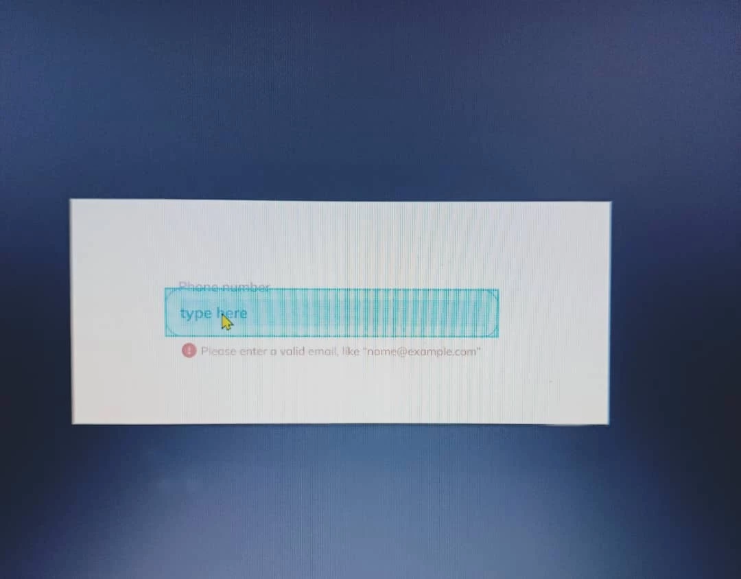

But I am still facing the same issue in prototype mode:
 Simpler interaction in Prototype mode

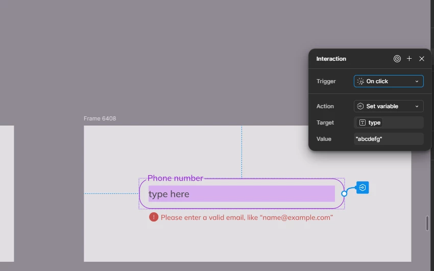

I also set it to “on click”
Sampler animation state to “on click”

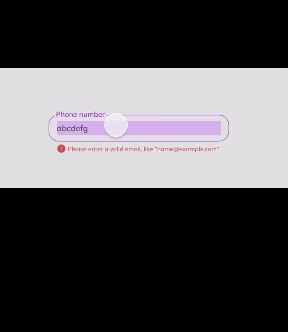

so I can try it out on mobile and works. (I used my Bluetooth mouse to test it out) but not on desktop:
Prototype on mobile
Have I done anything wrong? is this a bug? how do I solve this problem??

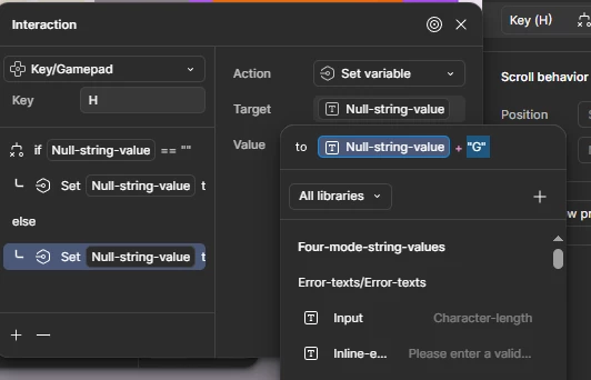

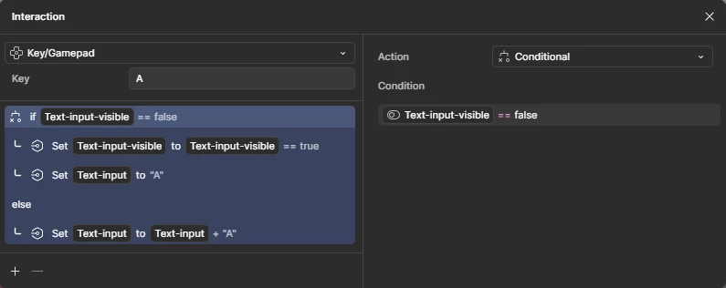

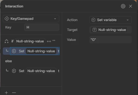

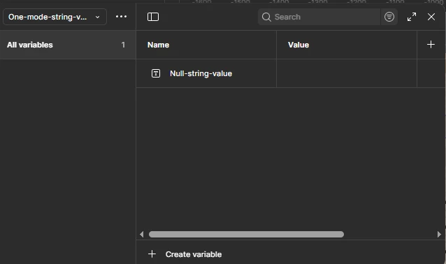

Okay guys, so I found a solution for this problem, I found a way to create a "null”  string variable and applied it to the string element instead of using a boolean variable for the prototype here.
Then I replicated the "null" string value for the gamepad and mobile keyboard interactions here:
Key/gamepad interaction view-1
Key/Gamepad interaction view-2

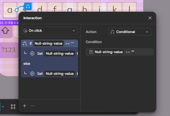

Here is the interaction for the mobile keyboard replicated but set to "on-click”
Conditional prototype set to "on-click" for the mobile prototype
And this variable that was created to carry out this prototype:

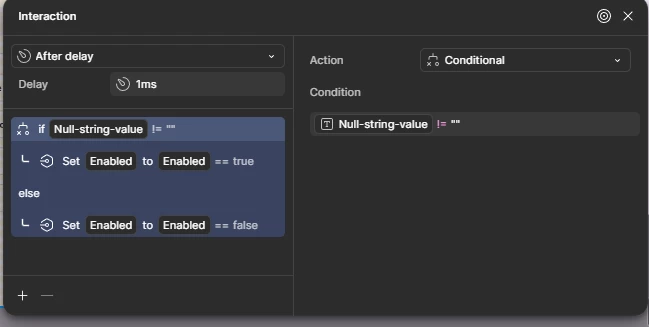

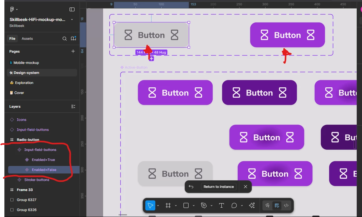

I spotted another issue, for this prototype, there’s a problem. I set null-string value to “” or null. then I created two button states (disabled and default) and assigned a a boolean value for these buttons states here:
Selected buttons states tied to a boolean variable
Boolean variable created

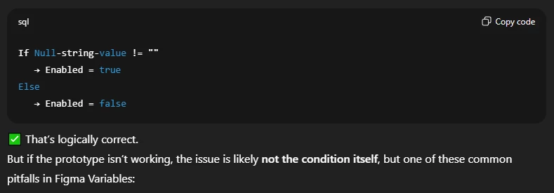

The interaction states that if “null-string-value” changes from null to anything else, then the button state should change to Enabled, else the button should be disabled
Which I confirm with Chatgpt to be logically correct:
Chatgpt’s response of my query on the interaction
