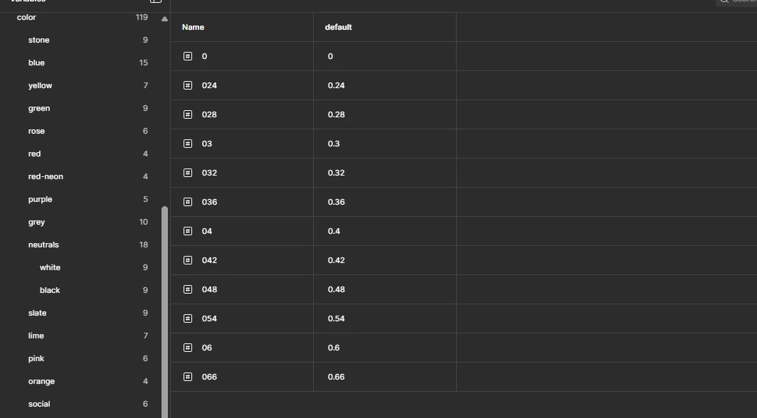

All our text styles are based on variables, including the letter spacing (see attached)

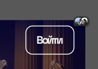

And the problem looks like
