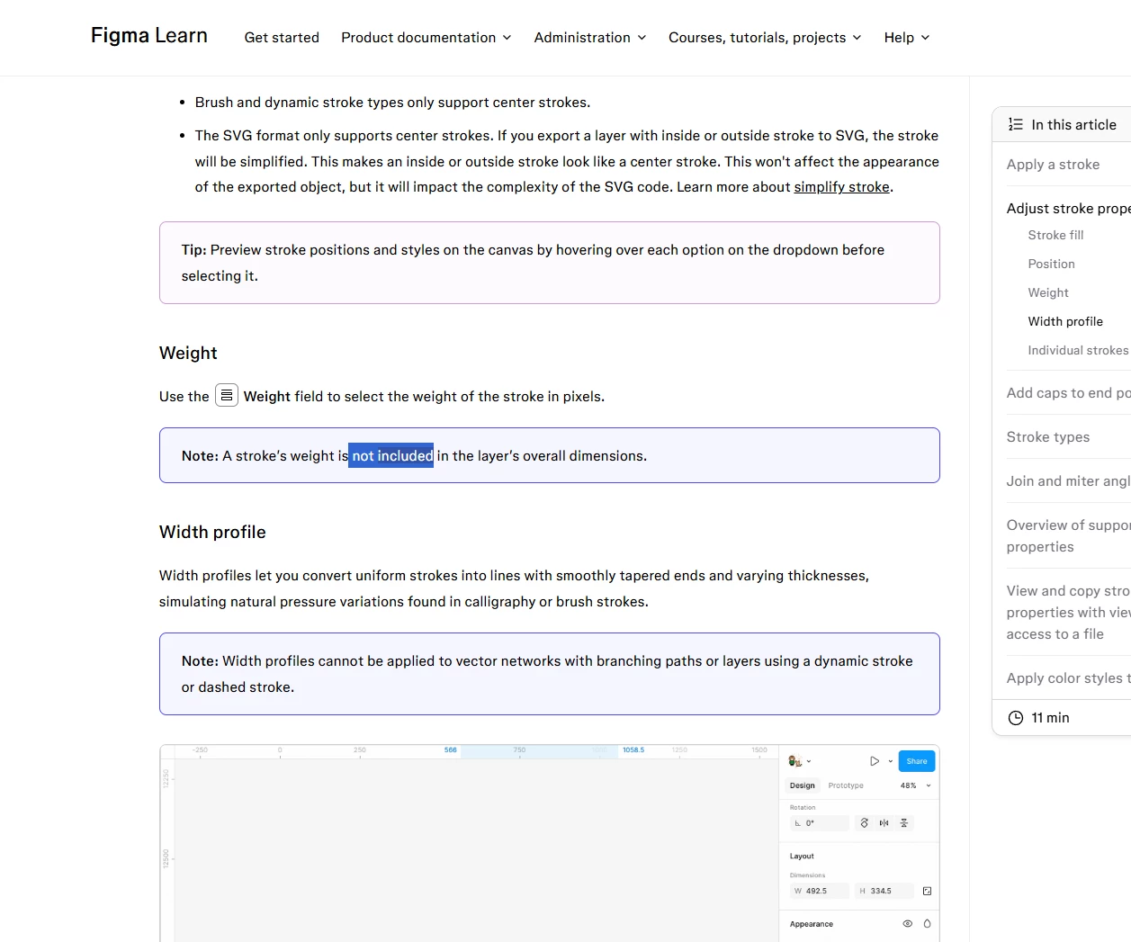

what REDADCTED decided to make this new logic? Strokes dont work like that in CSS
Celine_ just decided to straight up lie in her response
Also FIGMA LEARN contradicts this new logic, check it out yourself:
