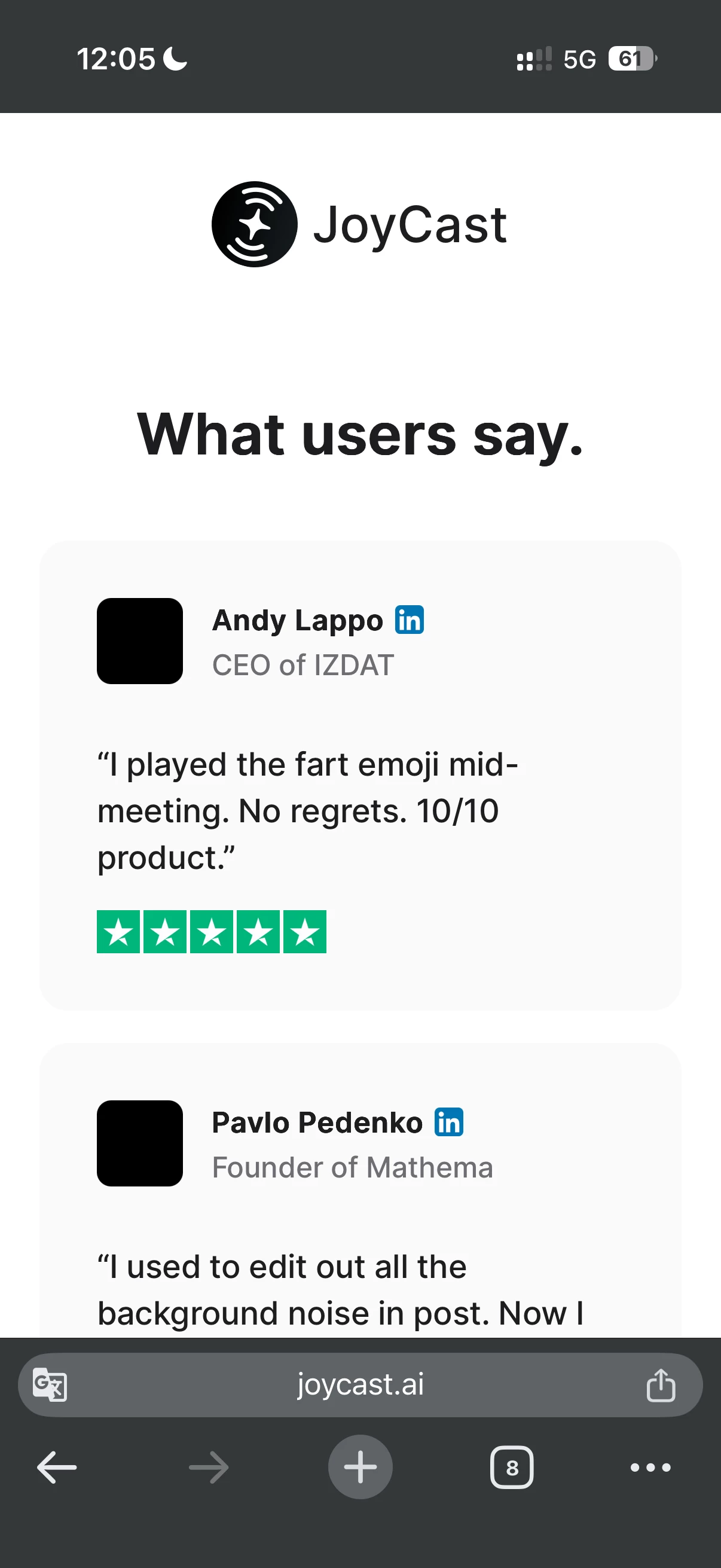

Images turn into black squares and only in mobile browsers
I have designed a website in Figma Sites. But after publishing I found that some images are not displayed, only black squares. The problem is only on mobile browsers (Chrome and Safari). In addition, if I minimize and maximize the browser a couple of times, the image will appear, but only the one that was in the visibility zone.

I’m having same issue. Only for some images though. Looks like your images are loading now though?

Hey All, thanks for reaching out about this!
​@Vladimir3 - it looks like support was able to help you out with this on ticket #1456237.
To help close the loop, support is able to view images as expected on mobile with the most recent iOS. This issue seems to be related to using the iOS 26 beta.
Images should work correctly on released OS and iOS versions, but we have a current compatibility issue with the iOS 26 beta version. Since beta versions can often have unexpected behaviors, we recommend using a stable OS release for the best experience with Figma Sites. Hope this helps!
