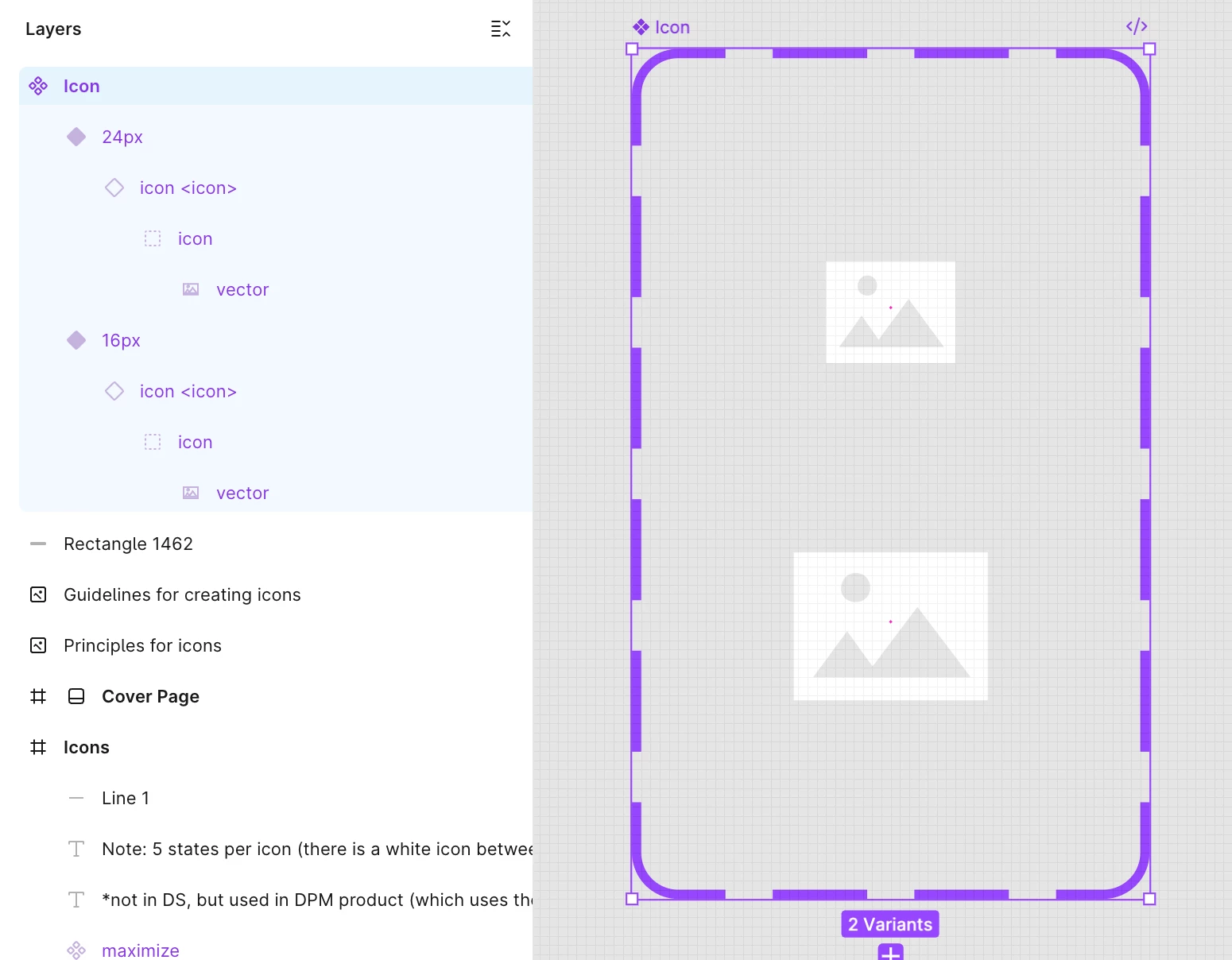

Icon instance color overrides when switching sizes (16px ↔ 24px) in component properties
I’ve been STUCK with this icon override issue for a week now and need help 🙃
Context:
  • I have an icon library structured as so:
  • In my button component, I’m using instances of this icon component and I’m applying specific tokens to override the default icon color.
What’s working:
  • Switching between icon variants (same size, e.g. 24px → 24px) works as expected
  • The icon correctly inherits the color token from the button
The issue:
  • When switching icon sizes (e.g. 24px → 16px), the icon resets to its default color
  • It overrides the token that was being applied from the button
  • This breaks the expected “inherit color” behavior
What I’ve checked/tried:
  • Verified layer structure is consistent across icons
  • Confirmed the token is applied at the button level (not hardcoded on the icon)
  • Instances behave correctly until the size variant changes
Question:
Is this expected behavior when swapping component instances across different sizes?
Or is there a recommended way to structure icon components/variables so color inheritance is preserved across size changes?
