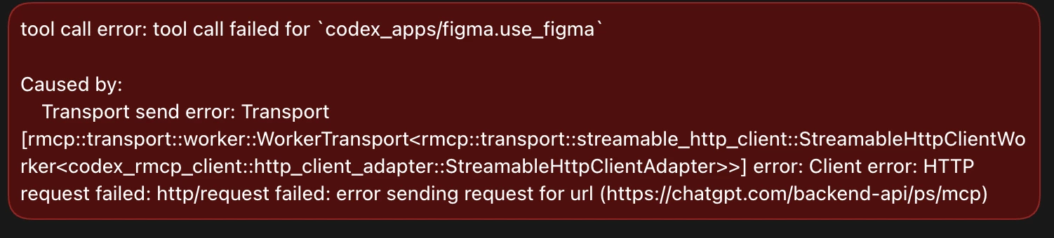

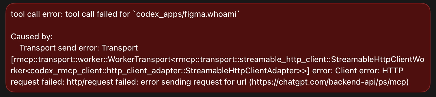

its always stuck and shows unreachable。

Ahh, thanks for the screenshots - very helpful! Did you originally connect Figma through chatgpt.com/plugins ? What you're running into happens when Figma is connected to Codex through the ChatGPT Apps/Plugins route rather than Codex's own dedicated Figma plugin.
Here's how to get it working with the Codex-specific connection instead:
  1. Open the Codex app and go to Plugins (upper-left corner).
  2. Click the + next to Figma.
  3. Click Install Figma to start the install.
  4. Complete the authentication flow and click Allow access to connect your Figma account.
You can find the full setup steps are here: Codex and Figma: Set up the MCP server. Once completed, you should see the Figma plugin connected and ready to use directly in Codex, without routing through chatgpt.com. Let me know if still have trouble after following the above steps.
