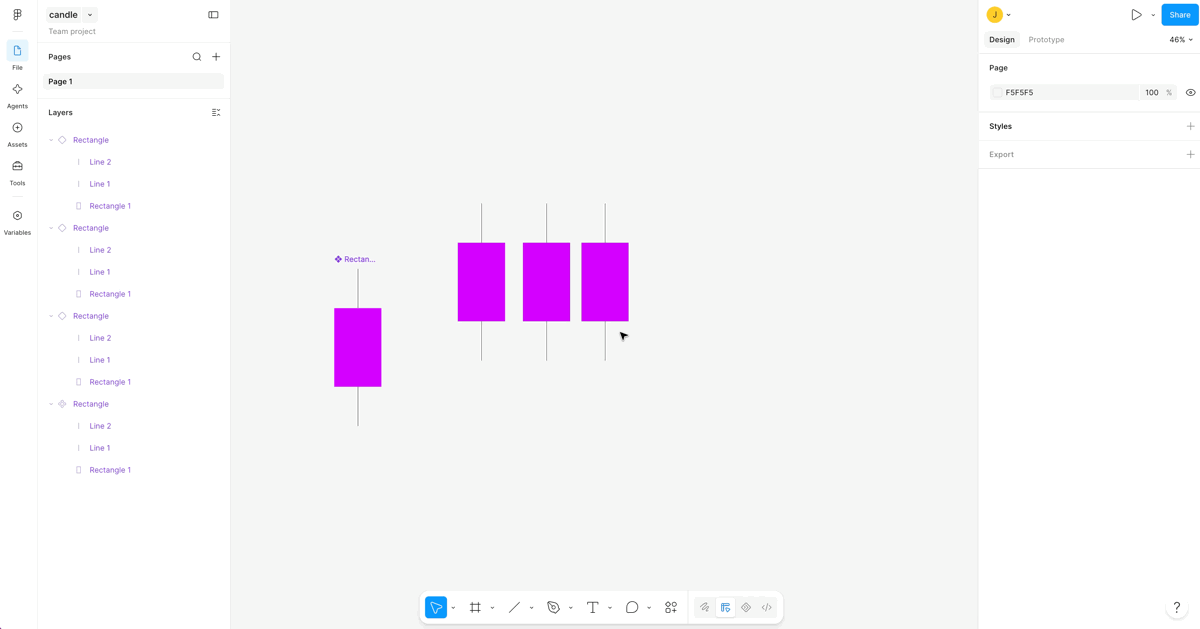

Hi, when I create a “candlestick” component, I am not able to edit the candle's "wicks" or candle’s “body” of the instances, which is an issue for me.
Because I need each candlestick to be different in terms of body size and wick size.
I would love to hear your feedbacks. I've attached a video to this post that illustrates the problem I'm having.

One thing worth checking first: in the Layers panel, do the wick and body inside your candlestick component each show a diamond icon (meaning they're their own separate components nested inside the candlestick), or are they plain rectangles/lines sitting directly in it? (a not zoomed-in screenshot showing your expanded left hand toolbar is helpful)
If they're nested components, that would explain what you're seeing — instances can only override certain properties, and size/structure changes can't be pushed onto a component that's nested inside another component. You'd need to make those edits on the main sub-component instead of the outer instance. More detail here: Swap components and instances.
If they're plain layers already, let us know and we'll look at the auto layout/sizing setup on the main component instead. Either way, happy to help! — Jaycee

No, the wicks and body of the candlestick component does not show any diamond icon in the layers panel. ​@Jaycee Lewis

Hi ​@Carmelo_ 👋 Thanks for the additional screenshots. This is the expected Figma behavior, not a bug.
Instances only support overriding a specific set of properties — text, fill/stroke, effects, layout guides, nested instance swaps, export settings, and layer name. Resizing or repositioning a shape layer (like your candle's body or wick) isn't on that list, so those fields stay locked on instances even though they're fully editable on the main component. More here: Apply changes to instances — Supported properties.
If every candle needs an independently different body/wick size, components + instances aren't the right tool for that — plain grouped shapes (not linked as instances) will give you more flexibility.
