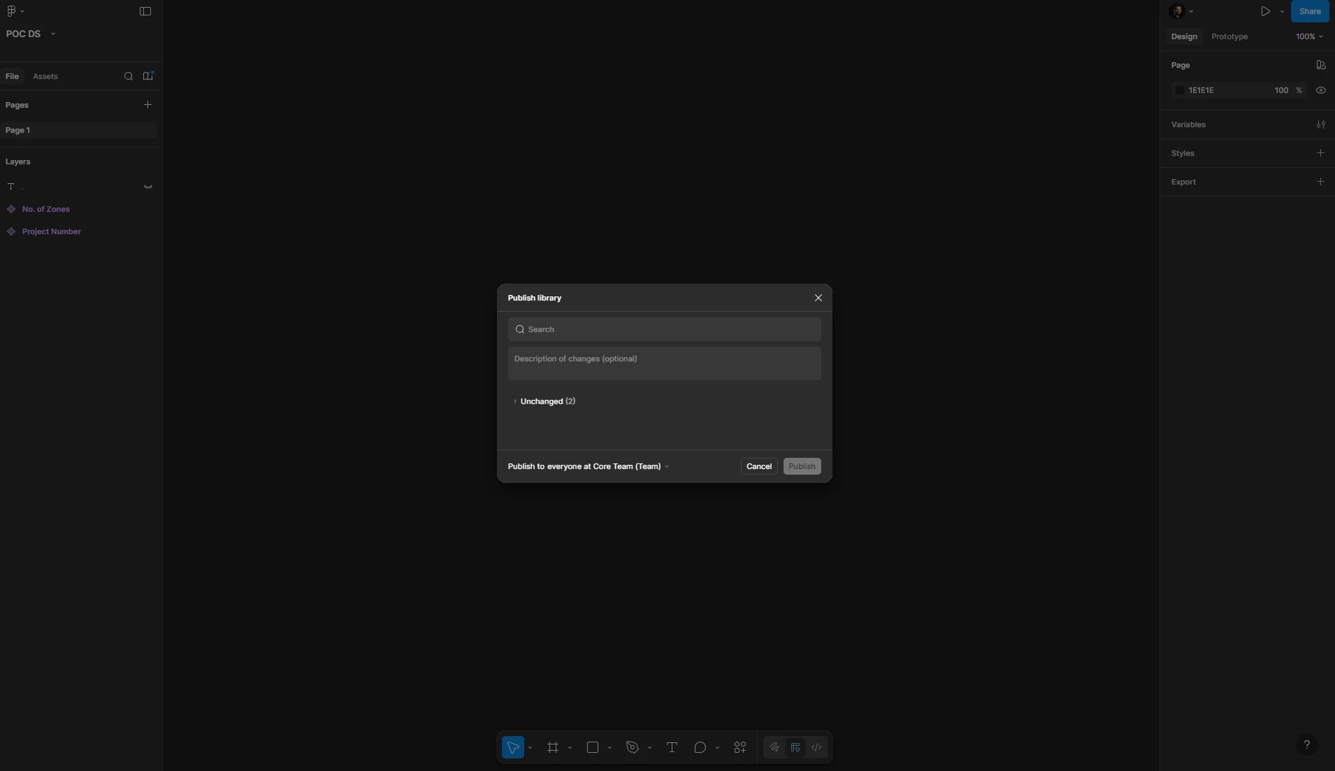

I am not able to see figma make option in my design system
I am not at all able to see figma make option in my design system eventhoug it is published and i have credit for figma make. I tried to create new design system to make sure my existing DS may have some blocker but even in new file it’s not working any soultion on this?

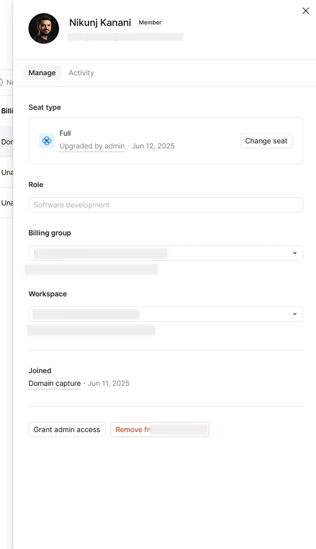

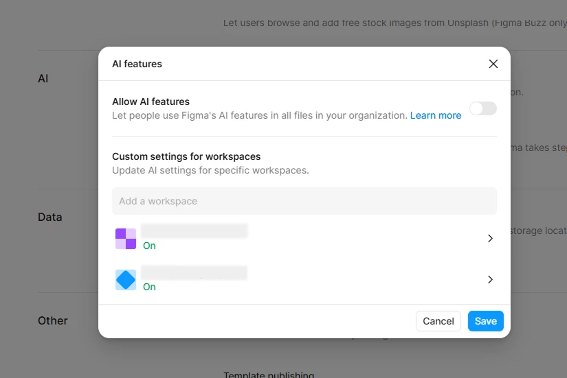

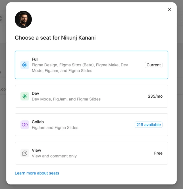

    Thanks for reply but i am raising this for my company’s account not for the email (redacted by the moderator due to PII) registerd with figma. i already cross check all this possibility priorly i already have full seat avaialbe for my account. The design system is already publish and the workplace where design system file is stored is already enabled for figma AI. Sharing couple of screenshot but even after all of this i am not able the figma make option.
    There is only possibilty my whole organisation do not have full seat or even enable for figma make due to which i may not see it but this do not looks problem to me as for my proflile and workspace it’s enable so it should work for me.

    Hi ​@Nikunj Kanani, thanks for following up with the screenshots!
    In the second screenshot, it looks like Allow AI features is toggled off. Since Figma Make is powered by AI features, your Org Admin must have Allow AI features toggled on in order for you to use Figma Make.
