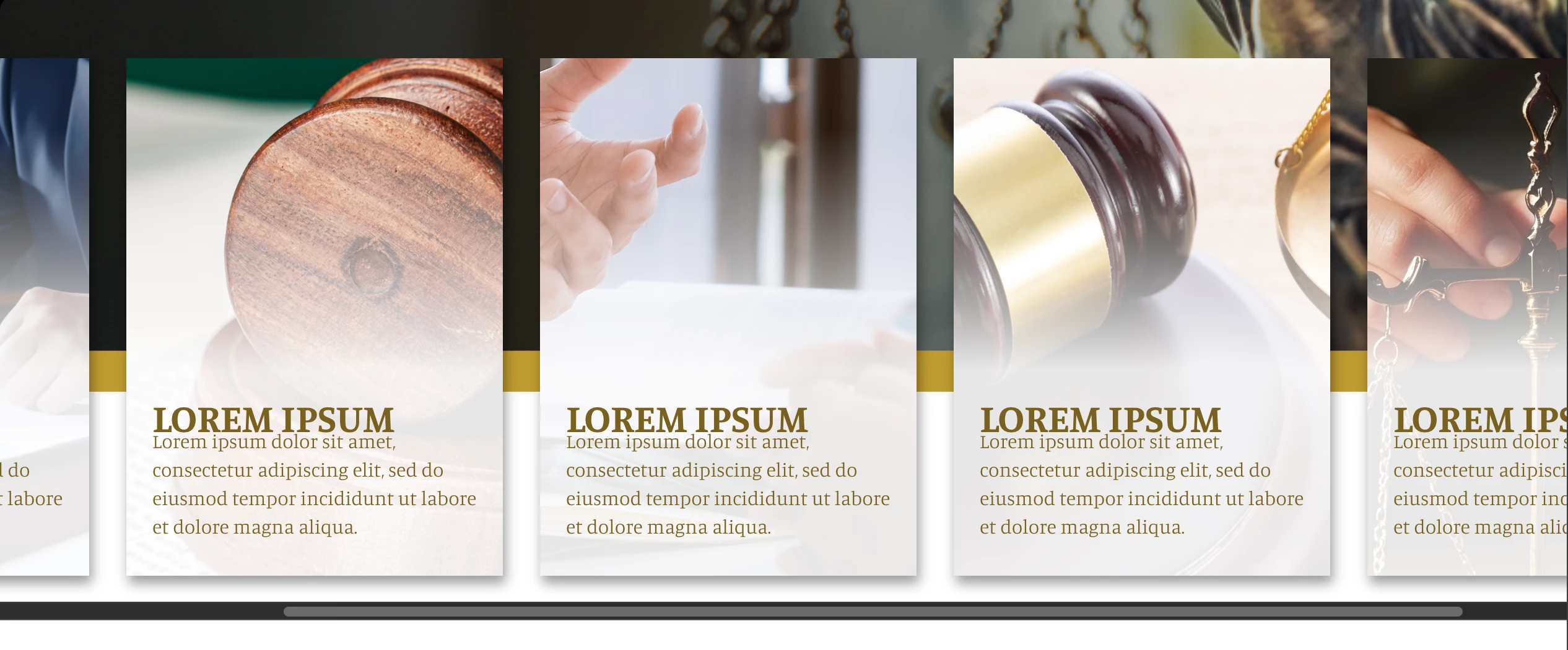

I’m using Figma Sites for my design portfolio and added horizontal scrolling to a frame. It works, but when I preview the site, a horizontal scrollbar shows up, and I want to hide it for a cleaner look.
Here’s what I tried:
  • Set the frame to horizontal scroll under overflow behavior
  • Tried to look for an “On Drag” interaction to make it feel swipeable — but it’s not available
  • Thought of using arrows + variants, but that’s a lot of work and not ideal
Is there any way to hide the scrollbar in Figma Sites? Or any better workaround?
