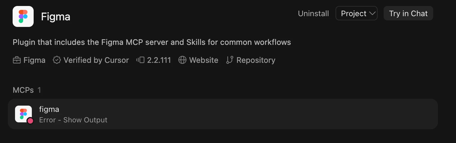

Vincent Koopmans
Sep 25, 2026 6:36 AM UTC
I have the exact same issue right now. not with Grok but trying to get the Figma plugin working.

m.politanskyi
Sep 25, 2026 4:15 PM UTC
Hi there, I have the same issue
  • MCP client (Cursor)
  • The exact error message:
    2026-09-25 19:06:47.510 [info] [V2] Handling CreateClient action
    2026-09-25 19:06:47.510 [info] [V2 FSM] connection:connect_start: conn=idle,auth=unknown -> conn=connecting,auth=unknown
    2026-09-25 19:06:47.847 [info] MCP OAuth provider initialized
    2026-09-25 19:06:48.520 [info] Successfully connected to streamableHttp server
    2026-09-25 19:06:48.520 [info] [V2 FSM] connection:connect_success: conn=connecting,auth=unknown -> conn=connected,auth=unknown
    2026-09-25 19:06:48.520 [info] CreateClient completed, connected: true, statusType: connected
    2026-09-25 19:06:48.724 [warning] MCP HTTP exchange completed
  • Any screenshots or screen recordings of the issue:

Sep 29, 2026 12:17 PM UTC
Thank you everyone, and for sharing the screenshot here. For visibility here, our support team has shared it to our Product team for MCP about the issue encounters by ​@최진철 . I’ve also shared this thread to our internal team. As soon as we have any updates, we will share here. Thank you for your patience and collaboration!
