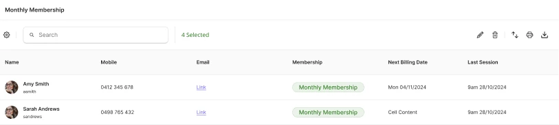

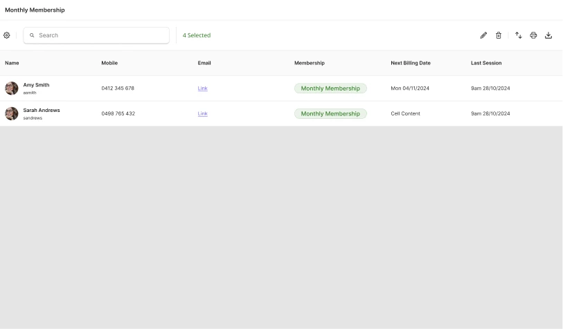

I can reproduce the issue consistently using the Figma MCP with the steps below:
Tests ran through Figma MCP `use_figma`.
- Problem: table grids expand to include hidden rows, leaving a large grey area. One grid changed from 3 rows / 182px to 11 rows / 670px while its 48 hidden cells remained hidden.
- Test method: I visually checked after each operation. Repairs and working baselines were confirmed before repeating failing tests.
- No visible change: listing styles, pages, variable collections and variables; reading style consumers and their parent paths; setting `skipInvisibleInstanceChildren=false`; resolving/switching pages; calling `page.findAll()` and returning only its length.
- Broke tables: after `page.findAll()`, reading each returned node’s `type` to count instances/components. Exact script reproduced the failure twice, each from a confirmed working baseline.
"code": "const nodes = page.findAll(); let instances=0, masters=0; for (const n of nodes) { if (n.type === 'INSTANCE') instances++; if (n.type === 'COMPONENT' || n.type === 'COMPONENT_SET') masters++; } return {nodes:nodes.length, instances, masters};"
- Broke tables again: `page.findAllWithCriteria({types: ['INSTANCE']})`, returning only the count. This avoided an explicit per-node type-reading loop but still caused visible corruption.
- Both failing approaches used `figma.skipInvisibleInstanceChildren=false`. Neither explicitly changed table properties or deleted a style.
"code": "const instances = page.findAllWithCriteria({types: ['INSTANCE']}); return {instanceCount: instances.length};"
- Workaround: show, then rehide one already-hidden Table Cell in each table.
- Before/after screenshots attached.
Please fix this issue. While there is a workaround, having to go through every table in the project and manually show and hide an already hidden cell in each table to force a refresh is a huge pain!
