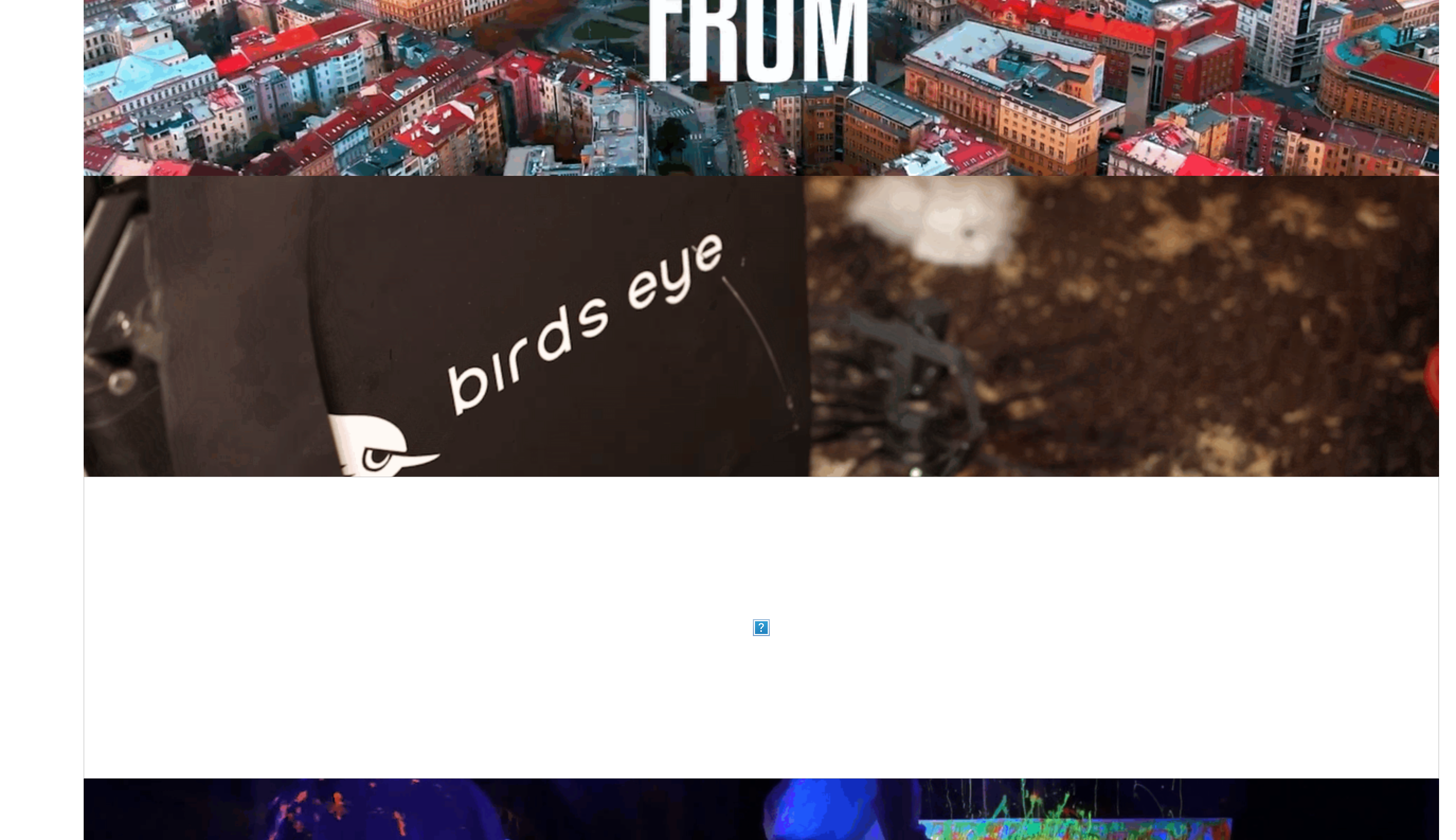

Hi Everyone!
On my Figma Site, when published, Some Gif’s will not appear and will show as a Blue question mark as image references below.
Any idea on How to fix this?

Hey ​@Braxton Mastre ,
Sorry to hear you're having trouble publishing GIF on Figma Sites!
 I checked internally, and our engineering team confirmed this issue can happen when the GIF is too large. Figma supports GIFs up to 50 megapixels, which means:
(width in pixels × height in pixels × number of frames) / 1,000,000 ≤ 50.
If that applies, please try resizing your GIF to a smaller one and try again.
If the issue persists, please reach out to our support team: Submit a bug report.
This will help us investigate further and try to reproduce the issue on our end. Please sure to use your Figma email account, include a link to the file, and share ‘can edit’ access with support-share@figma.com, so we can take a closer look.
