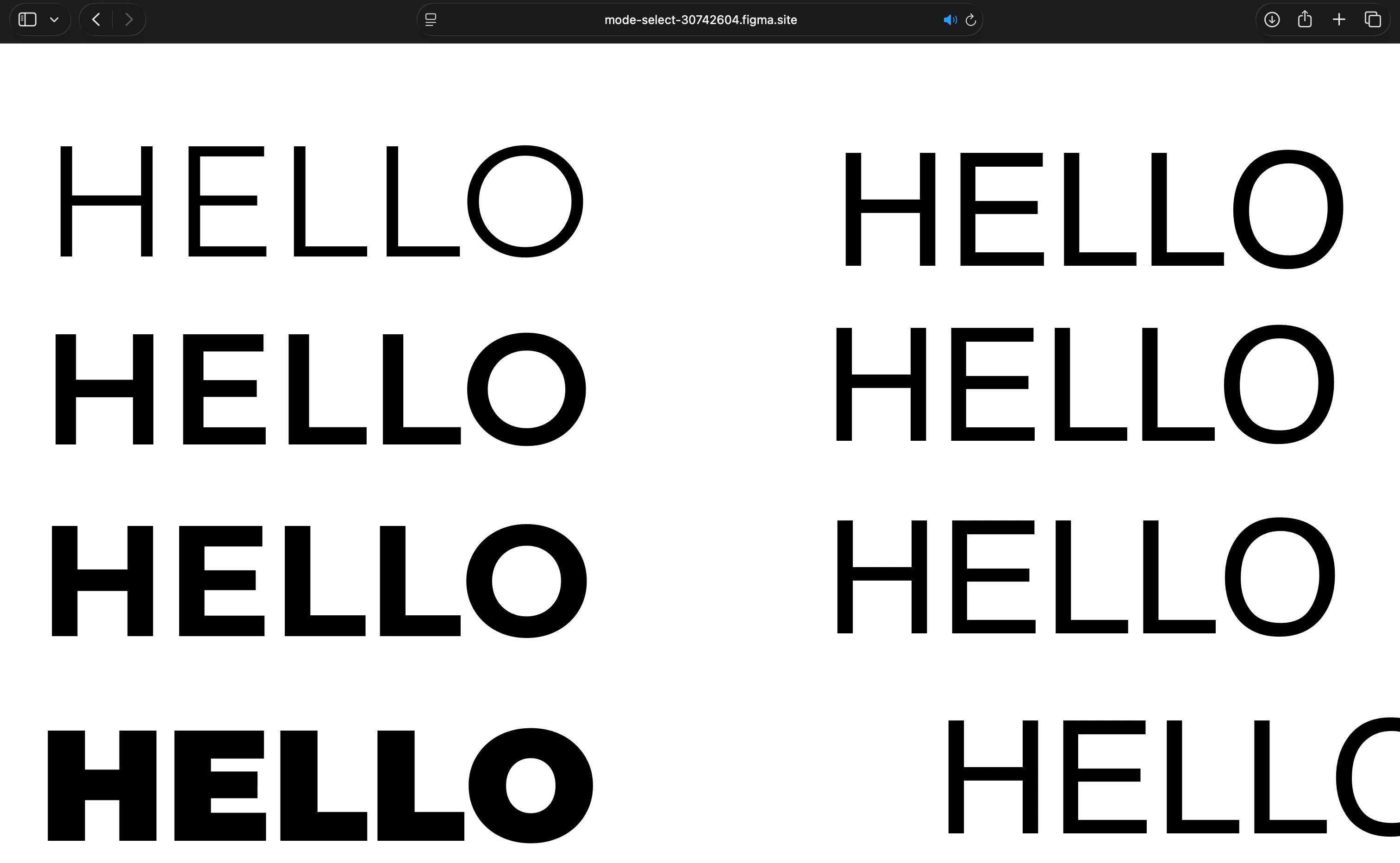

  1. Context: I reported an issue with font weights not rendering correctly on my Figma Sites website after publishing it on September 11. Although I have been using Helvetica Neue throughout the project for over a month without any font-related issues, all font weights, including Medium, Bold, and Condensed Black, are now being rendered as Regular Helvetica Neue on the published site.

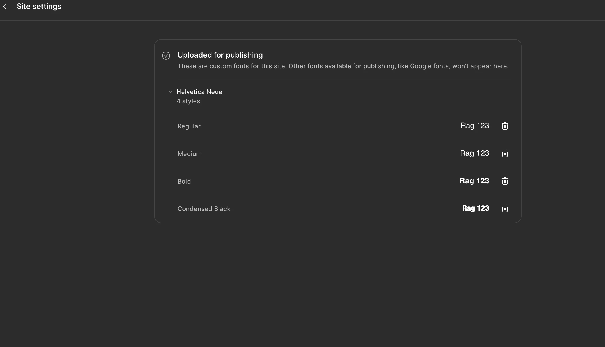

1. The setting

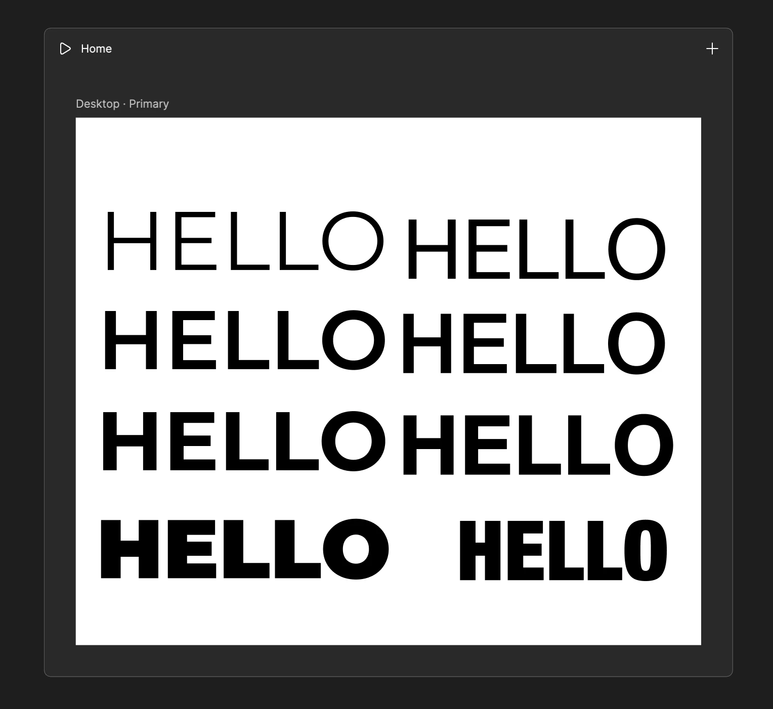

2. The design file

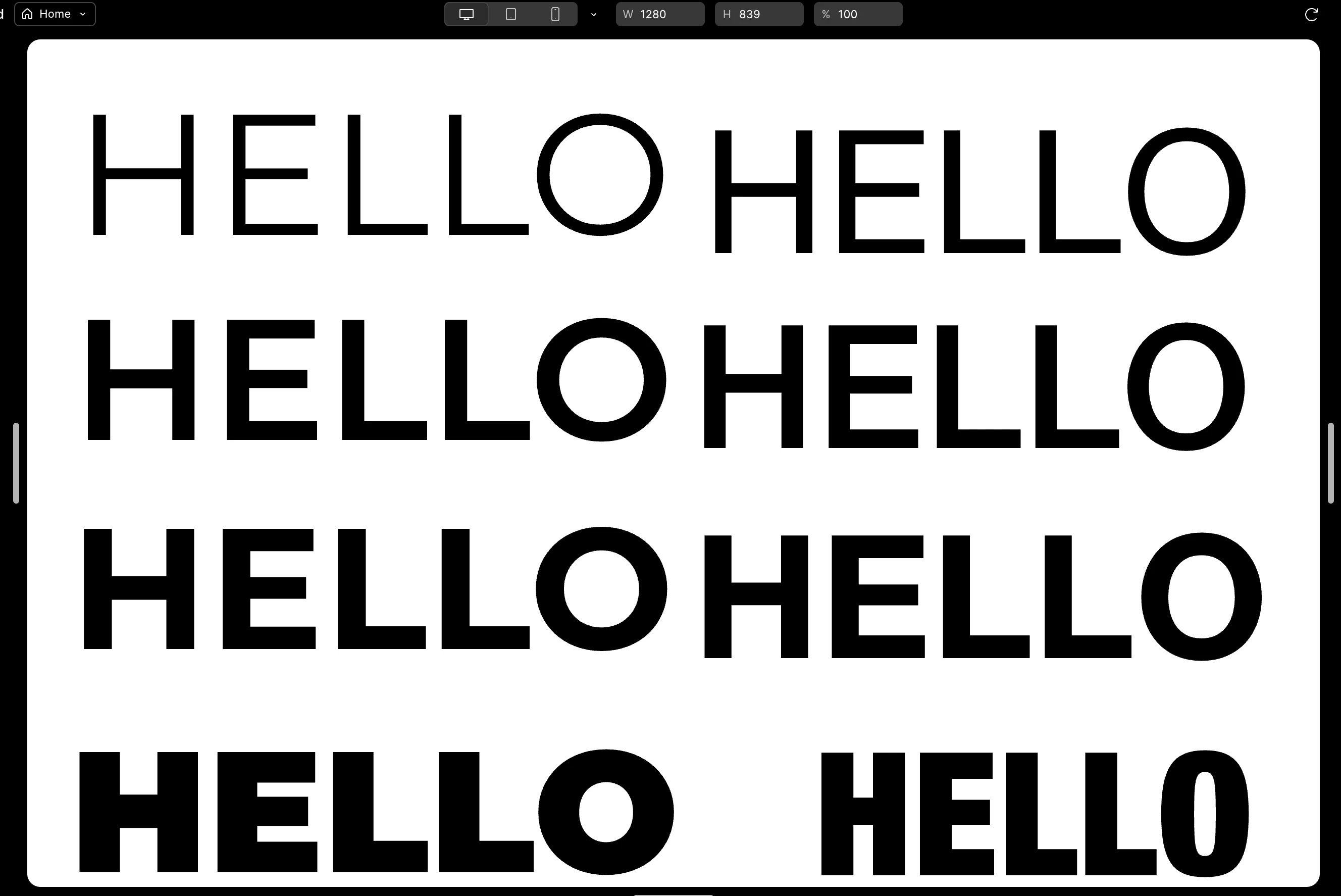

  1.  The preview
    1. The published site
